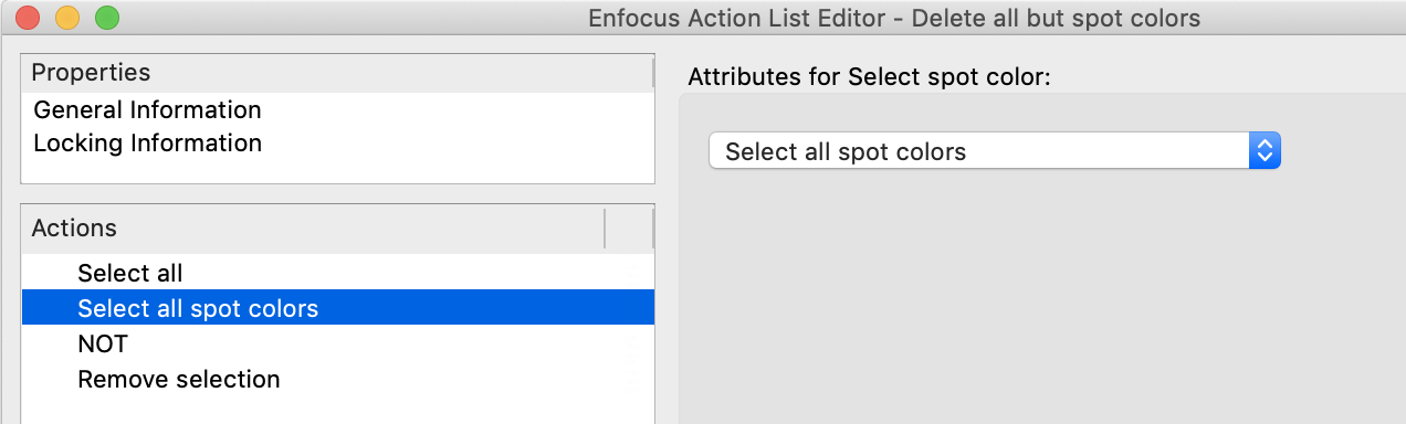

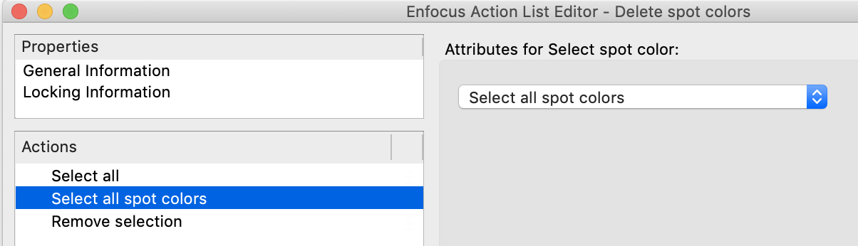

Very easy, here are the two action lists:
Delete spot colors.png (73.25 KiB) Viewed 9501 times
Delete all but spot colors.png (78.38 KiB) Viewed 9500 times
Using PitStop Server and Switch Core Engine (licensed with PitStop Server), you can automate this:
duplicate the document, apply each action list, and rename the two files.
