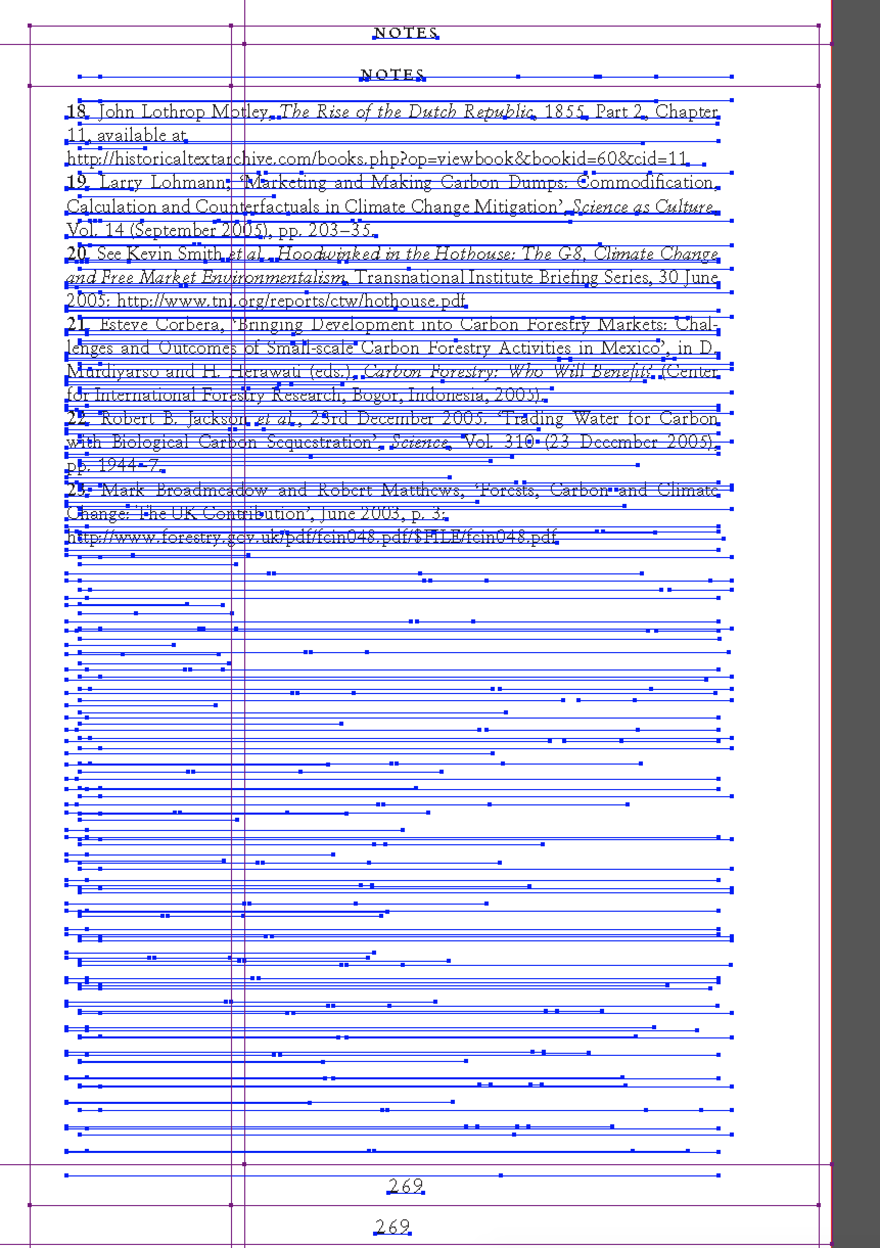

I attached a pdf 269.pdf there is invisble text in that page. Please let us know how to identify this kind of issue in pitstop profile or action list. I also attached screen shot for your reference.

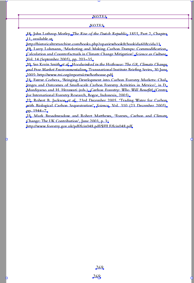

try to use the Clean Up Content action.

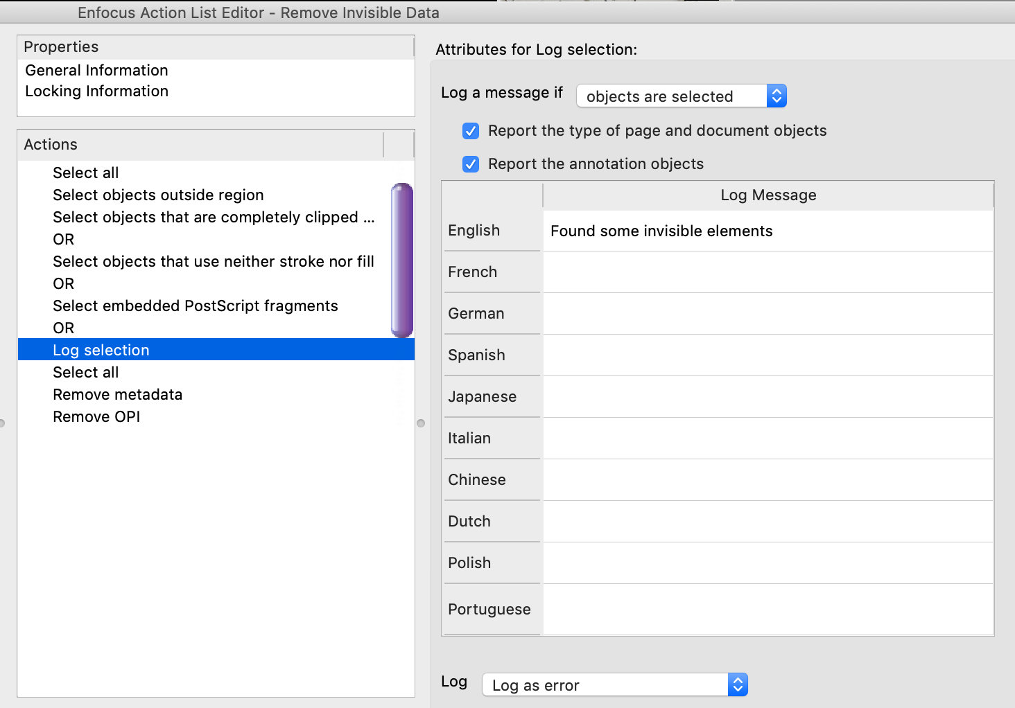

Use the "Remove Invisible Data" action list to remove it.
If you just want to be warned (instead of deleting), edit the action list and replace "remove selection" with "log selection"

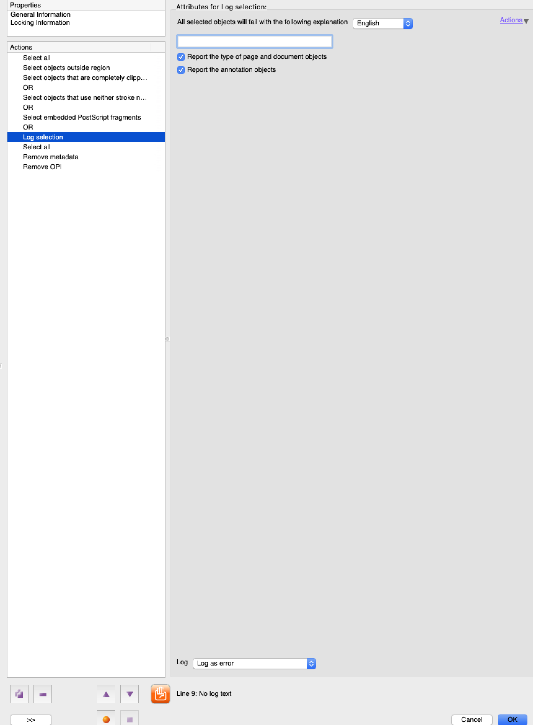

As you said I just need the warning or Error report. But if I change the "remove selection" to Log selection it shows error. I attached for your reference. It shows No Log text.

Well, you have to define yourself the error message you want to log.
My screenshot is a bit different, due to the different version of PitStop.
Note you can report the presence or absence of selection (using a more recent version of PitStop)

Thanks for your support, It working fine now.
