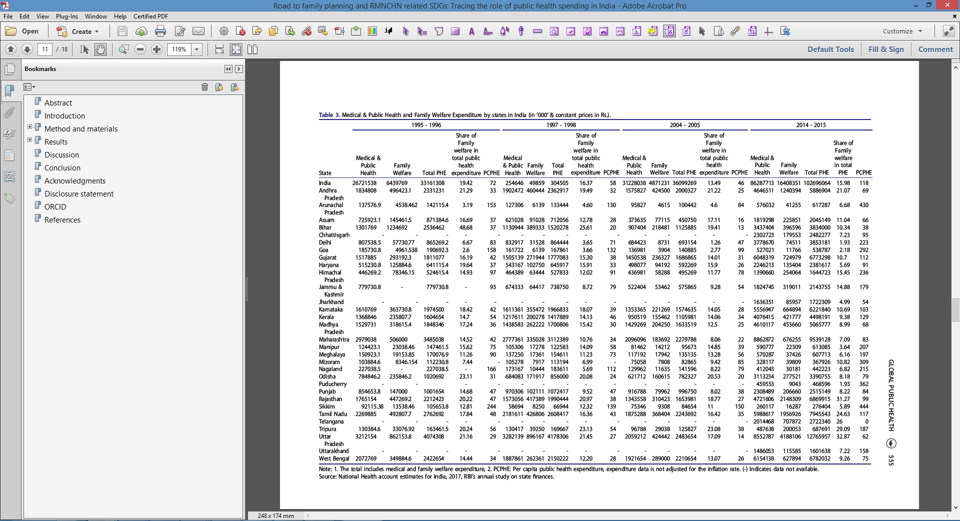

Our PDF contains Landscape Table content in Portrait mode. So, we want to Rotate the Landscape Tables content pages in to Landscape Mode.
Sample screenshot attached in below..
Input
Input
Output
Output

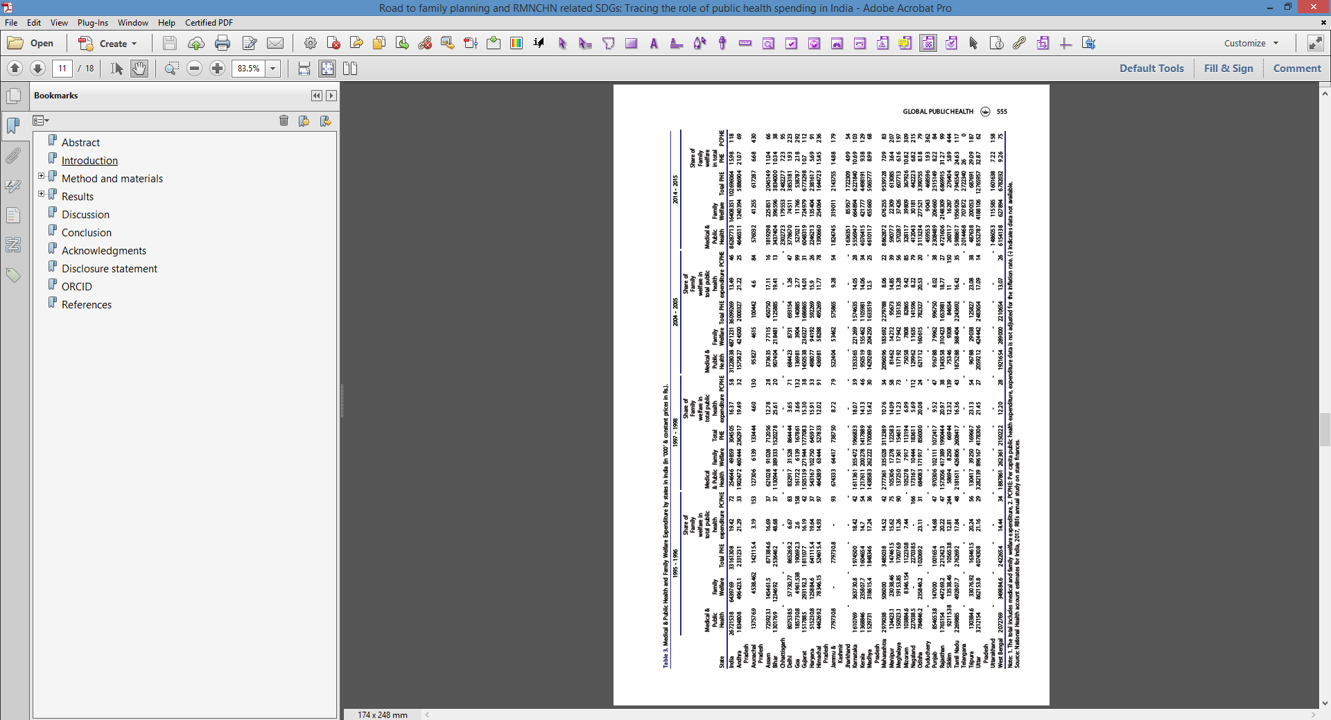

It doesn't work to our files. If i run the actions list, whole pages are rotated.
I need to rotate only if the page contains Table. Not for whole document. Refer screenshot for output.

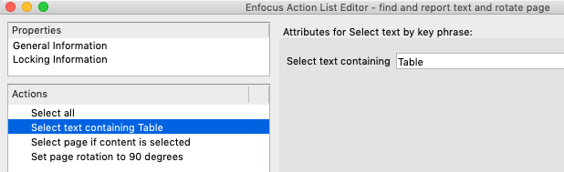

You can base your selection on a specific text (ex "Table", if all tables are rotated).
Then select the pages (if objects are selected) and rotate them.
select text.png (31.42 KiB) Viewed 7870 times

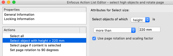

If this is not accurate enough, you can base your selection on the vertical lines in the tables.
select object.png (36.75 KiB) Viewed 7870 times

Probably best to have an 'AND' after the two selections before the rotation.
