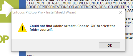

When trying to update to 2021, the installer gives me an error.
Which folder should i select? My acrobat is installed to C:\Program Files (x86)\Adobe\Acrobat DC

There are 2 installers now for Windows PitStop Pro, 32 and 64 bit.
If Acrobat is 32bit and you try to install the PS 64 bit you get this error.
You need to check the bit version of Acrobat and PS to match.

i got the error with both installers at the beginning but now it worked. thanks!
