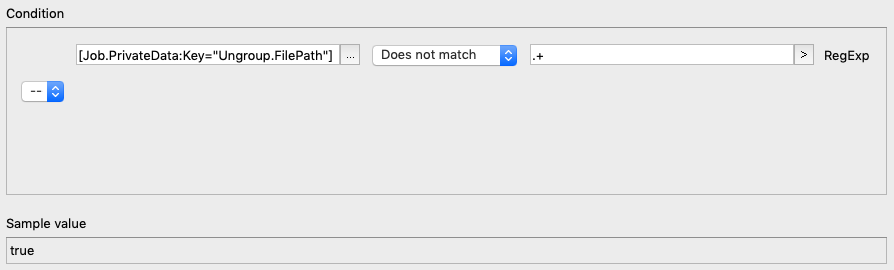

Ungroup Job saves private data so that it is possible to assemble the job again later.
<key>.FilePath is the relative path of this file within the parent job folder.
More info here: https://www.enfocus.com/manuals/UserGui ... p_job.html
It is interesting to notice that the <key>.FilePath private data is not added to the files on the top level the job folder, because it is not necessary. So, ungroup the job, sort the files based on the condition in the screenshot (will return true for the top level documents), preflight the top level pdfs, and assemble the job again after the preflight.
