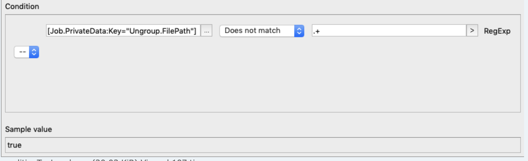

This is a follow up to a question I asked earlier. I know I can filter out PDFs on the top level of a folder. If I ungroup, I can direct files from the top level using
[Job.PrivateData:Key="<Ungroup>.FilePath"] Does Not Match .+ (RegExp)
From there I filter out PDFs. So if the job has three PDFs on the top level, the end folder receives those 3 PDFs. Any other PDFs in subdirectories are not included.
