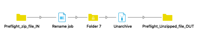

Hi
What I want to do is unzip files and have them sent back to where they came from.
Directory path would always be changing.
My idea was to have the directory path with 2 underscores added as a prefix to the name of the zipped file.
I can do that, not a problem.
Then drop it on a Switch folder.
Rename the zipped file back to Original, but have it log the directory path somehow.
Then unzip, and send it back to the directory path.
How can I get the directory path logged and the info back into the end of the flow to send it back?
Or does anybody have a better way to do it?
Thanks in advance.
unzip flow to send back.png (9.92 KiB) Viewed 14592 times

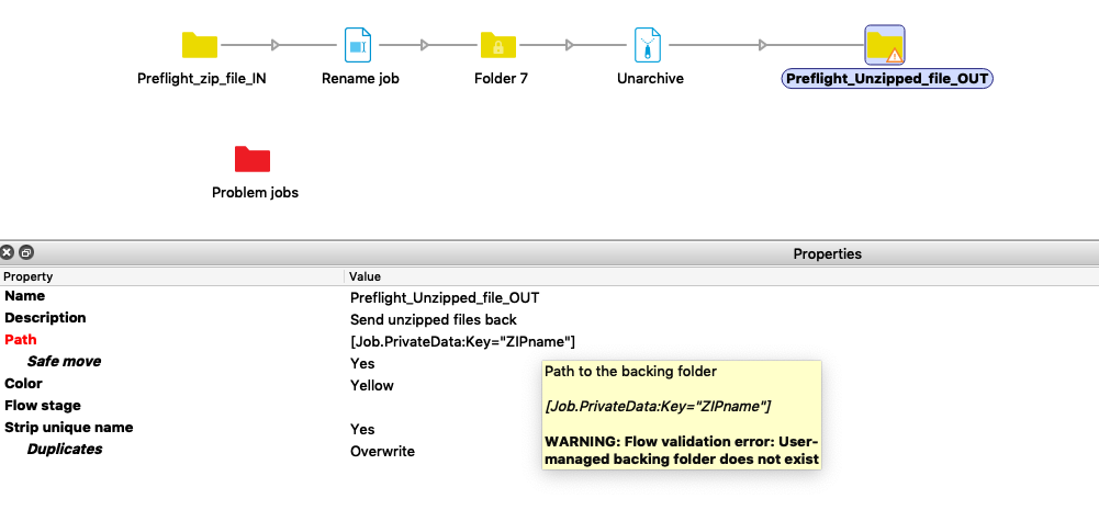

But I jumped the gun. My theory is flawed from start. Because I cannot add directory path as a prefix on the name of the zipped file.
I get -filename prefix contains one or more characters that are not valid in filenames.
I will have to rethink how to do this.
I liked the idea of the variable path and maybe I could still use it somehow. But I could not get it to execute.
At the end of the flow, it did not seem to take the variable as a path. The flow would not activate.
Maybe I was entering something wrong somewhere.
send back path.png (70.86 KiB) Viewed 14551 times

On the first folder under Set job private data I entered the variable -
OUTpath=[Job.Origin]
Then on the last outgoing folder in path, I entered -
[Job.PrivateData:Key="OUTpath"]
But flow will still not activate. The warning says the value of Path is not valid.
Where am I going wrong?

Ok If I understand you right you want the last folder in your flow to have a variable path. You can't do that with an folder.
You have to use Set hierarchy path and Archive hierarchy instead.
With Set hierarchy path you use your variables for your path and then Archive hierarchy uses that path to save to disc with a defined root folder where your variable folders will be created.

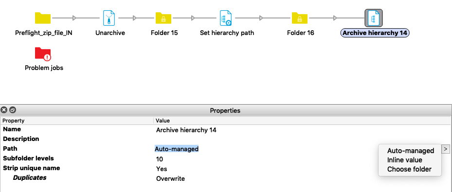

If I am wrong here is my other issue:
In the Set Hierarchy path, I put
Action Add to top
Path segment 1 [Job.PrivateData:Key="OUTpath"]
In the last Archive Hierarchy flow element.
What would go in the Path?
jan_suhr
Posts: 709
Location: Nyköping, Sweden
Re: Trying to send files back to a directory that changes
Post by jan_suhr »
The Pah property is for the hierarchy root folder. Like MyDisk/Jobfolders/
And after that you have your folder structure for your jobs.
The path you get from the start already contains the first parts and you have to filter them out from that variable.
To the right you have After, Before, Segment and Search.
Look here:
https://www.enfocus.com/manuals/UserGui ... tions.html
Jan Suhr
Color Consult AB
Sweden
Check out my apps

Hi jan_suhr
Good news, I have it working now.
I had added some of the variables I needed on the original job name and then created private data for that.
I used that private data to set my hierarchy, using the filters before and also after.
Thank you for your replies and guidance.
