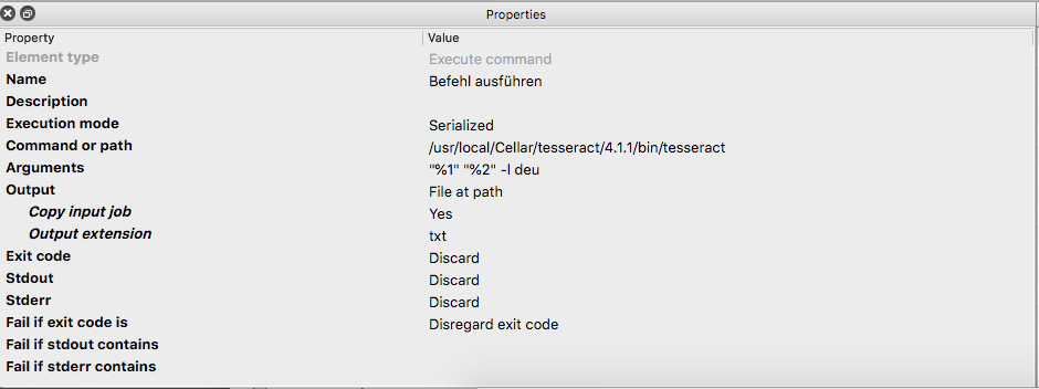

I would like to use Tessesract via Switch. Unfortunately I get the following error message:
Cannot complete sendToSingle() for '/Users/switch/Library/Application Support/Enfocus/Switch Server/temp/251/ScriptElement/88/319/ExecuteComandResult/test.txt'
Cannot send job: path '/Users/switch/Library/Application Support/Enfocus/Switch Server/temp/251/ScriptElement/88/319/ExecuteComandResult/test.txt' does not exist
These are the settings of Execute Command:
I have also found the cause of the problem. Tesseract automatically sets the extension txt. I have not found a way to change this.
So I have a double txt-extension for the output file, which cannot be found by Switch:
/Users/switch/Library/Application Support/Enfocus/Switch Server/temp/251/ScriptElement/88/319/ExecuteComandResult/test.txt.txt
Is there any way to specify the argument "%2" without the file extension? Or another idea?

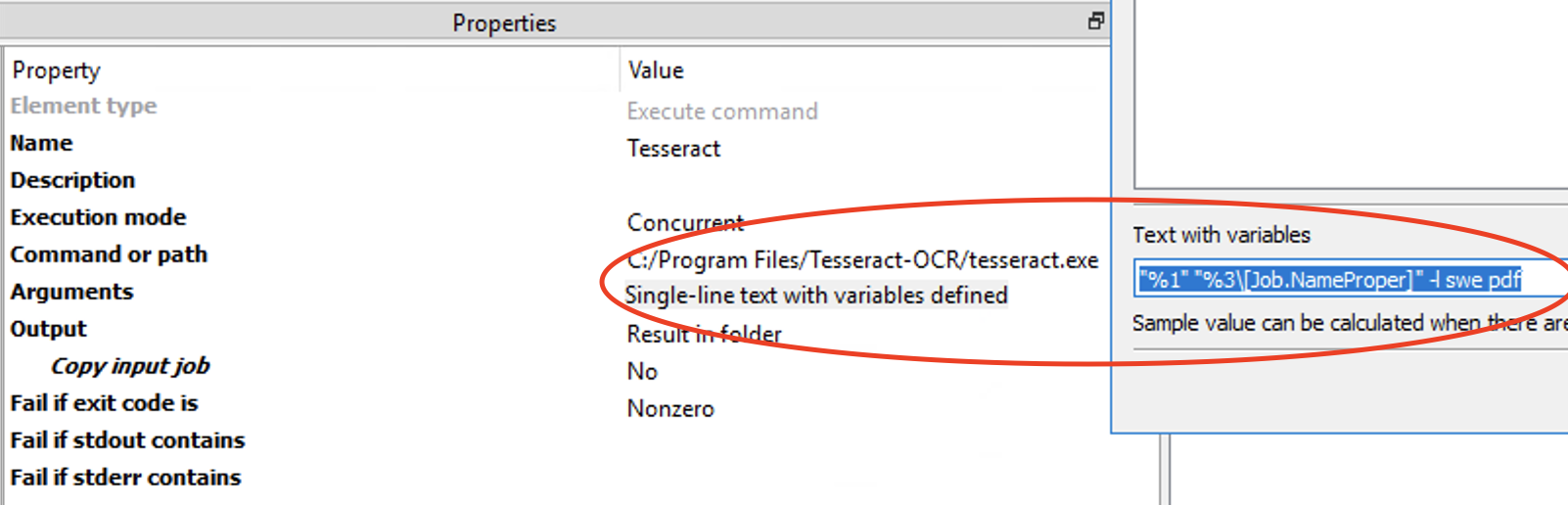

Hi, you can use Execute Command as well, I posted a screen shot of the setup in the last messege in this thread: viewtopic.php?f=12&t=3812&p=11690&hilit ... act#p11690
alahode
Posts: 7
Joined: Thu Aug 12, 2021 3:42 pm
Location: Germany
Re: Switch and Tesseract
Post by alahode »
Hi magnussandstrom.
That works just as well. Thanks for the tip!
