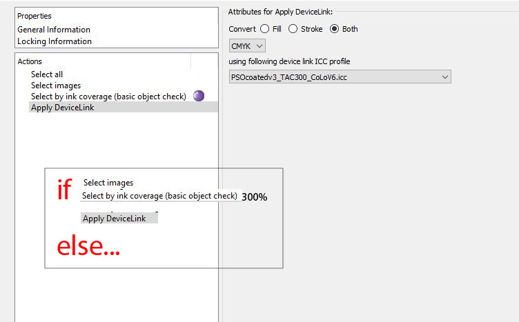

Could you help me how to insert the "if", "else" commands into the action list.
Thanks!
if....else
if....else
- if_else.jpg (59.8 KiB) Viewed 14510 times

There is no explicit if...else in Action Lists, but implicitly the selection does that for you.
Select images
Select by ink coverage
AND
Apply DeviceLink
This will apply the DeviceLink only on the selected objects - and the only selected objects are images with ink coverage over 300%.
The AND selects objects that were selected by _both_ of the previous two selects.
An OR would select objects that were selected by _any_ of the previous two selects.

I didn't mean that, because if you find an one image in it that is over 300%, then the whole document should be handled, not just that one image.
