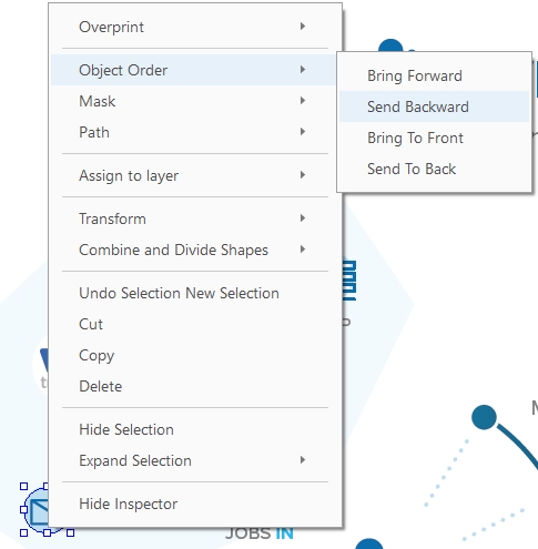

I am using Windows 10, Acrobat Pro DC 32-bit, PitStop 2021 and the contextual menu appears. Please advise of your configuration. Thanks.

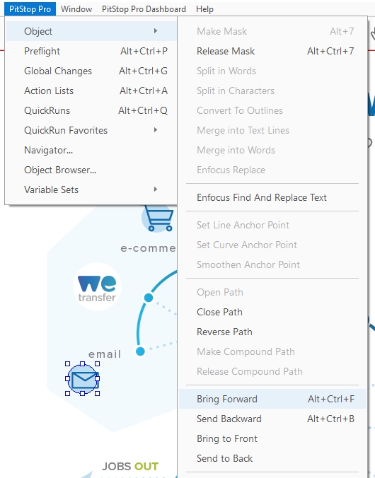

You can perform this from the menu: PitStop Pro>Object>Bring Forward

I am using windows 10, Acrobat Pro 32 bit 'Continuous Release - Version 2021.007.20099', Pitstop Pro 2021-- I used to have those dialog choices, exactly like what you showed, but I came in one day and they were gone. I did not change anything. The Mask options are gone also. I see they are both still there in the Menu item, but they have disappeared from the right-click context dropdown menu. I just downloaded and re-installed Pitstop. No change. I suspect Acrobat Pro did and update, the entire context menu is diferent, it even has icons at the top of the Right-Click Context Menu.

Adobe Acrobat release (v2021.011.20039) on Windows and macOS appears to have changed the behavior of the PitStop Pro tools contextual menu. When selecting an object using a PitStop Pro tool and then right-clicking, the contextual menu does not include all the PitStop Pro options, however, the complete list of options is still available in the PitStop Pro menu in the Acrobat menu bar.
There is also a workaround explained in the Knowledge Base article:
https://enfocus-community.force.com/cus ... uage=en_US
To summarize the KB article: keeping a toolset panel open from the Acrobat tool pane will allow the contextual menu to behave as expected.
