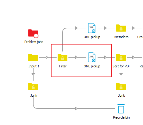

I've added a screenshot of my flow. First of all, the tool absolutely will not allow me to add a second connection. I was trying to make one from the Pickup to the Junk folder seen in the screenshot. The existing connection from the Pickup to the Sort for PDF folder has no option anywhere on it that I can see to create a success or error choice. Finally none of these have a stoplight symbol and nowhere do I see a stoplight symbol when I try to make new connections. So I'm feeling quite dumb at this point.
The second XML Pickup (not in the red box) can be ignored as that branch is working fine and is used for another bit of testing.

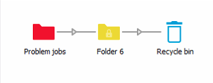

The "XML pickup" flow element doesn't support an error connection as far as I know.
I have solved similar issues before by letting the job go to problem jobs, and then adding a folder after problem jobs, and a recycle bin after that.
Skärmavbild 2021-11-19 kl. 09.24.32.png (14.16 KiB) Viewed 11625 times
On the connection between problem jobs and the extra folder you can then choose "Define condition with variables", and then you filter based on "Job.FailElement" and "Job.FailMessage" (you can find what to look for in the error mail that you got from the problem job).
That way you don't send every problem job to the recycle bin, only these specific instances.
