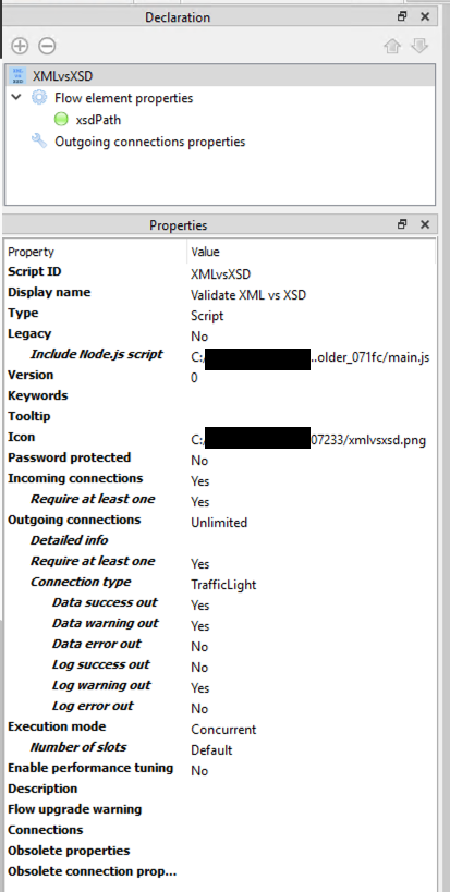

And also my propertie xsdPath is setup:
Bildschirmfoto 2021-12-06 um 15.05.02.png (139.44 KiB) Viewed 5172 times
