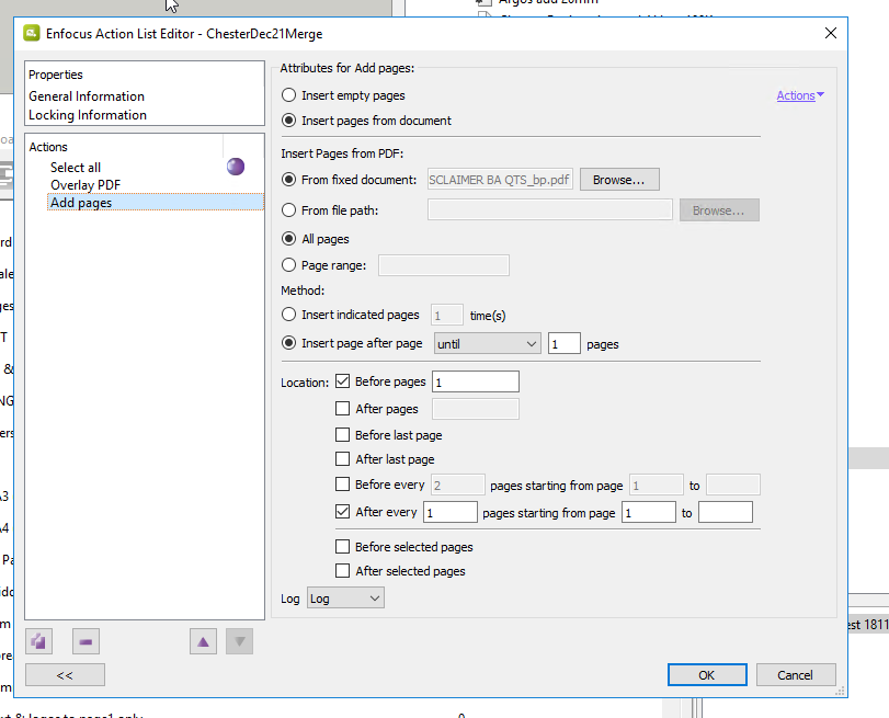

There's a pitstop action to add a page - but I cant seem to get it to do anything?! I have tried multiple way of setting it up... Could there be something obvious im missing?
Screenshot 2021-12-13 110203.png (46.74 KiB) Viewed 4915 times
