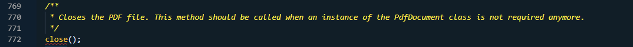

The following error is thrown when using SwitchScriptTool to compile to a sscript file:
Error: TypeScript standard output: C:/Program Files/Enfocus/Enfocus Switch/SwitchScriptTool/obfuscator/node_modules/@types/switch-scripting/index.d.ts(880,3): error
TS7010: 'close', which lacks return-type annotation, implicitly has an 'any' return type.
C:/Program Files/Enfocus/Enfocus Switch/SwitchScriptTool/obfuscator/node_modules/@types/switch-scripting/index.d.ts(1208,3): error TS7010: 'close', which lacks return-type annotation, implicitly has an 'any' return type.
And then after re-installing @types in local project the error is thrown from the index.d.ts in the switch-scripting local.
Error: Failed to transpile the code: TypeScript failed with exit code 2
Error: TypeScript standard output: node_modules/@types/switch-scripting/index.d.ts(772,3): error TS7010: 'close', which lacks return-type annotation, implicitly has
Can anybody suggest a reason for this, as this is internal to the Enfocus Script Tool? I have attached a screenshot of the error shown in the index.d.ts as is in the switch-scripting folder.
Typescript compile error in index.d.ts
- index.d.ts.png (114.85 KiB) Viewed 13785 times

Made a new empty project to check what index.d.ts is under the new version of Switch. That line is still close();. No return type specified.
Project then transpiled by either specifying in index.d.ts:
close():any;
Or changing code to:
// @ts-ignore
close();

On further thought that line should probably be:
close():void;
close():void;

The problem appears because you are probably using a tsconfig.json file which contains the compiler flag noImplicitAny.
I logged it and it will be corrected in the typings file. As a temporary workaround you could remove that compiler flag.

It would have been this line in tsconfig under compiler options:
"strict":true,
that would have been picking up that no return type was being explicitly stated.

Hey, this issue has been solved in Switch 2022 Spring.
