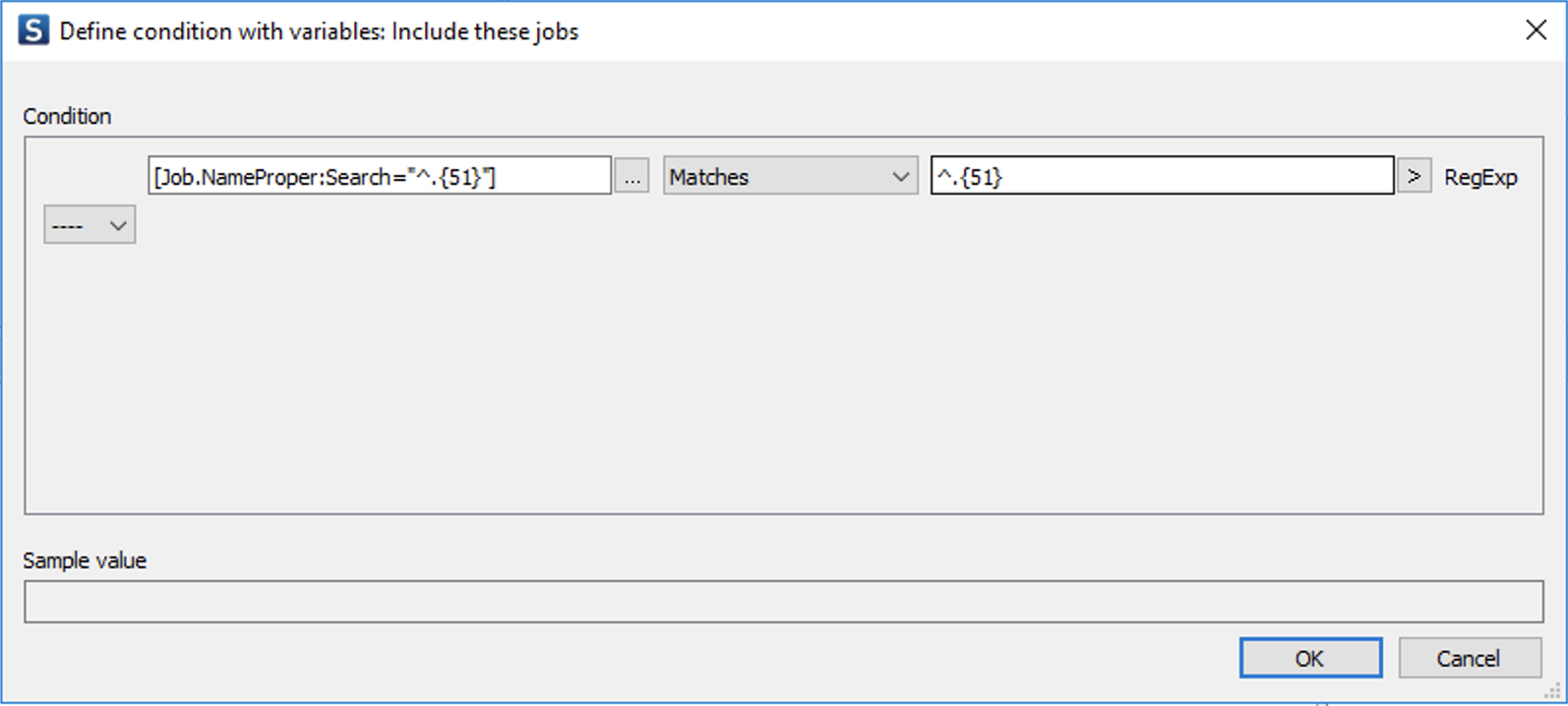

I need to send files to a specific outgoing connection if NameProper is more than 50 characters. Is there a simple way to do that?

Two outgoing connections, one with a condition that uses a regex .{50,} (any character 50 or more times) and one with "All other jobs". Simple enough? :D

Ah, I actually did solve it before your answer Freddy. :D Thanks! Now I have two ways of doing it.
