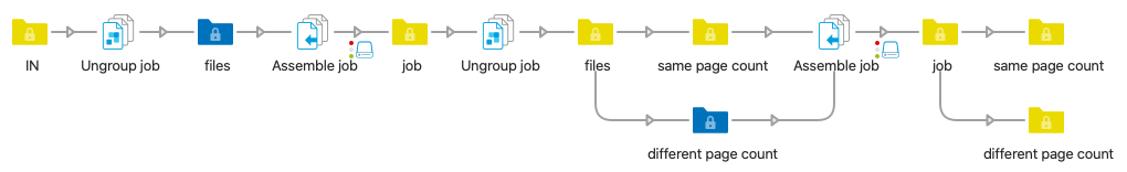

I'm failing on a problem I thaught would be simple: I want to route a jobfolder to folder A, if all contained PDFs have the same page count. If not, route job to folder B. Any hints on this? Thanks!

Here is a flow to solve this:
• First ungroup the job and write the number of pages of each file in a private data, "pages".
• Assemble the job with metadata merge, the "pages" private data will be the one of one of the files in the job.
• Ungroup the job again, and check if the number of pages of each file equals the "pages" private data.
• If not, add a "pageCount" private data with value "different".
• Then assemble the job again with metadata merge.
• Sort the jobs based on that "pageCount" private data.
sort jobs with different page count.png (19.83 KiB) Viewed 5284 times
sort jobs with different page count.sflow.zip
(15.11 KiB) Downloaded 718 times

Hi Laurent, thank you so much, this does exactly what I need!
Tobi
