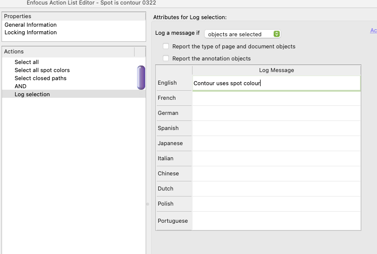

You're nearly there.
You would need to add a log selection
Screenshot 2022-03-13 at 09.10.17.png (47.82 KiB) Viewed 10250 times
It shouldn't pick up non spot contour.
If you can post your action and test file it makes it easily to understand what isn't working for you.

That's exaktly me aktionlist, but i select also fills (spotcolor) with stroke (without spotcolor).
Thats my problem ;) I need to select only stroke with spotcolor.
Unfortunately, I can't upload the test files because it keeps telling me that the archive is too big, even though it's only 300 kb. :(
Thx
Posts: 1189
Re: Select only Stroke with spot color
There is no action to select objects with a stroke. There is the action "Select color" where you can make a choice between "Fill", "Stroke" (or both). The downside is that you have to choose a specific "User swatch", you cannot select all spot colors. I assume you want to check for the presence of dielines in which case the number of possible names will be limited. If my assumption is correct you could use multiple "Select color" actions combined with multiple OR operators (always 1 less than the number of select actions they combine):
Select color A
Select color B
Select color C
OR
OR
Log selection
