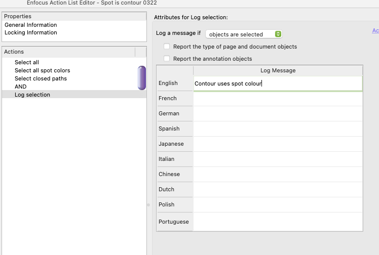

You're nearly there.
You would need to add a log selection
Screenshot 2022-03-13 at 09.10.17.png (47.82 KiB) Viewed 9786 times
It shouldn't pick up non spot contour.
If you can post your action and test file it makes it easily to understand what isn't working for you.

That's exaktly me aktionlist, but i select also fills (spotcolor) with stroke (without spotcolor).
Thats my problem ;) I need to select only stroke with spotcolor.
Unfortunately, I can't upload the test files because it keeps telling me that the archive is too big, even though it's only 300 kb. :(
Thx
