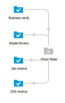

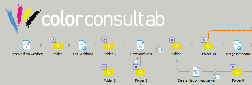

Using the switch API you can have submit points as templates for Webforms. It is also very simple for a Switch user to edit the files shown in the webform. They just change the properties of the Submit point and the webform will update without any knowledge about web programming.
The Ghost folder is just there for the Submit points to work win Switch, there is no content or information coming in that way. The submit points are just there to present themselves for the Switch API calls from the web portal.
The web page then sends a web hook to the Switch flow and if needed uploads job files with HTTP-requests.
In the case below, the web portal uploads the job file to that web server temporarily and Switch gets an XML with path to the file for download.
On the upload to the server the job file will get a random filename that is web-friendly. The original file name is in the XML and Switch renames it back to its proper name.
The upload function is done in the web portal code.
