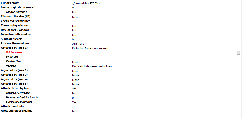

I have had a look at implementing your theory. But couldn't understand how it works. Do you have an example you could share?
My thinking was "Attach Hierarchy Info" was for when the files are found and I want to store files later in the flow with the same naming convention?
FTP Receive.png (29.9 KiB) Viewed 13348 times
My problem is collecting the files from The Root folder eg "Nick FTP Test" Whih has Multiple Tiltes in but we only need to Recieve the ones requested.
I was thinking "Process These Folders - All Folders" and "Excluding Folders Not Named" Populating the "Folder name " to whatever the path requested is eg "Reprint/Book Series/Book1 or New Titles/Book1 or any other title they need"
but there is a very good chance I am wrong in my thinking :lol:

I do not think you can get the FTP Receive to do what you want.
FTP Receive does not allow input connections.
If you make a submit point where somebody inputs the data about where to get the files, then you should be able to use a command line utility to get the file.
Will it be the customer or an internal customer relations person, which will input the data?
If you use FTP Receive as in your example and have Leave originals checked, then you should be able to download everything from a certain folder level.
But it will get download in the intervals defined at FTP Receive and not when somebody initates the job via a submit point.
