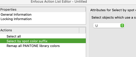

You'll need to select spot by suffix and remap to the desired Pantone library.
Repeat for each suffix needed
The attachment Screenshot 2022-05-06 at 15.21.29.png is no longer available
Screenshot 2022-05-06 at 15.21.29.png (21.98 KiB) Viewed 18798 times

Hi again, unfortunatly the select by spot color suffix does not work for me. I'm guessing since the Action 'Remap all PANTONE library colors' applies to all PANTONE colors in the document regardless of the previous select.

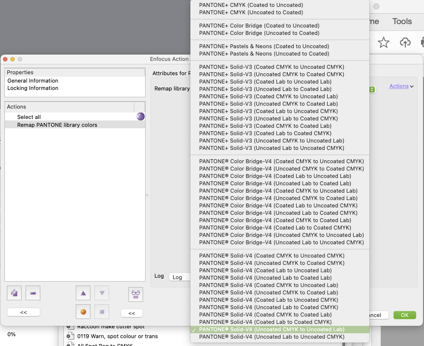

Ah, can you try using the change
Remap PANTONE library colors as per the grab.
This work here.
Screenshot 2022-05-09 at 11.24.14.png (217.13 KiB) Viewed 18752 times

I can't get it to work unfortunatly. Here is a link to my test file and wanted result: https://bit.ly/3PafoaI

Can you try this action please, attached zip.
Re: Pantone mapping
Posted: Mon May 09, 2022 2:26 pm
by JimmyHartington
I have also given it a go.
My action list first selects PANTONE C and remaps. Then PANTONE U and remaps.
https://d.pr/f/m2TMXZ+
Re: Pantone mapping
Posted: Tue May 10, 2022 12:39 pm
by magnussandstrom
Thanks Malcolm and Jimmy! You both came to the same conclusion. This is working!
