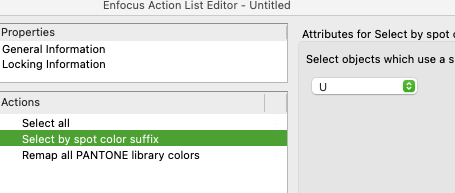

You'll need to select spot by suffix and remap to the desired Pantone library.
Repeat for each suffix needed

Hi again, unfortunatly the select by spot color suffix does not work for me. I'm guessing since the Action 'Remap all PANTONE library colors' applies to all PANTONE colors in the document regardless of the previous select.

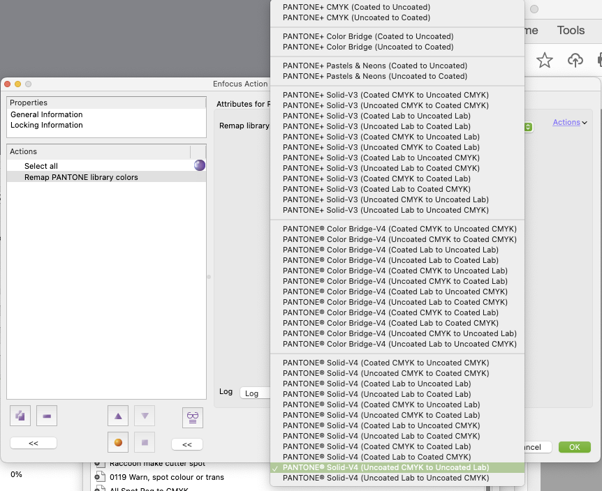

Ah, can you try using the change
Remap PANTONE library colors as per the grab.
This work here.

Re: Pantone mapping
Post by magnussandstrom »
I can't get it to work unfortunatly. Here is a link to my test file and wanted result: https://bit.ly/3PafoaI
