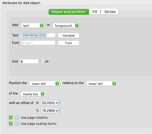

I've done this line by line.
Bit fiddly but once done it worked.
It might help someone here.
Add object and set offset.
Add object change offset up/down or across
Screenshot 2022-05-27 at 15.39.35.png (40.82 KiB) Viewed 214864 times
