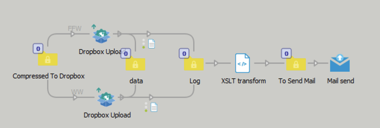

Here is my flow:
Screen Shot 2022-05-31 at 9.54.48 AM.png (118.43 KiB) Viewed 9383 times
