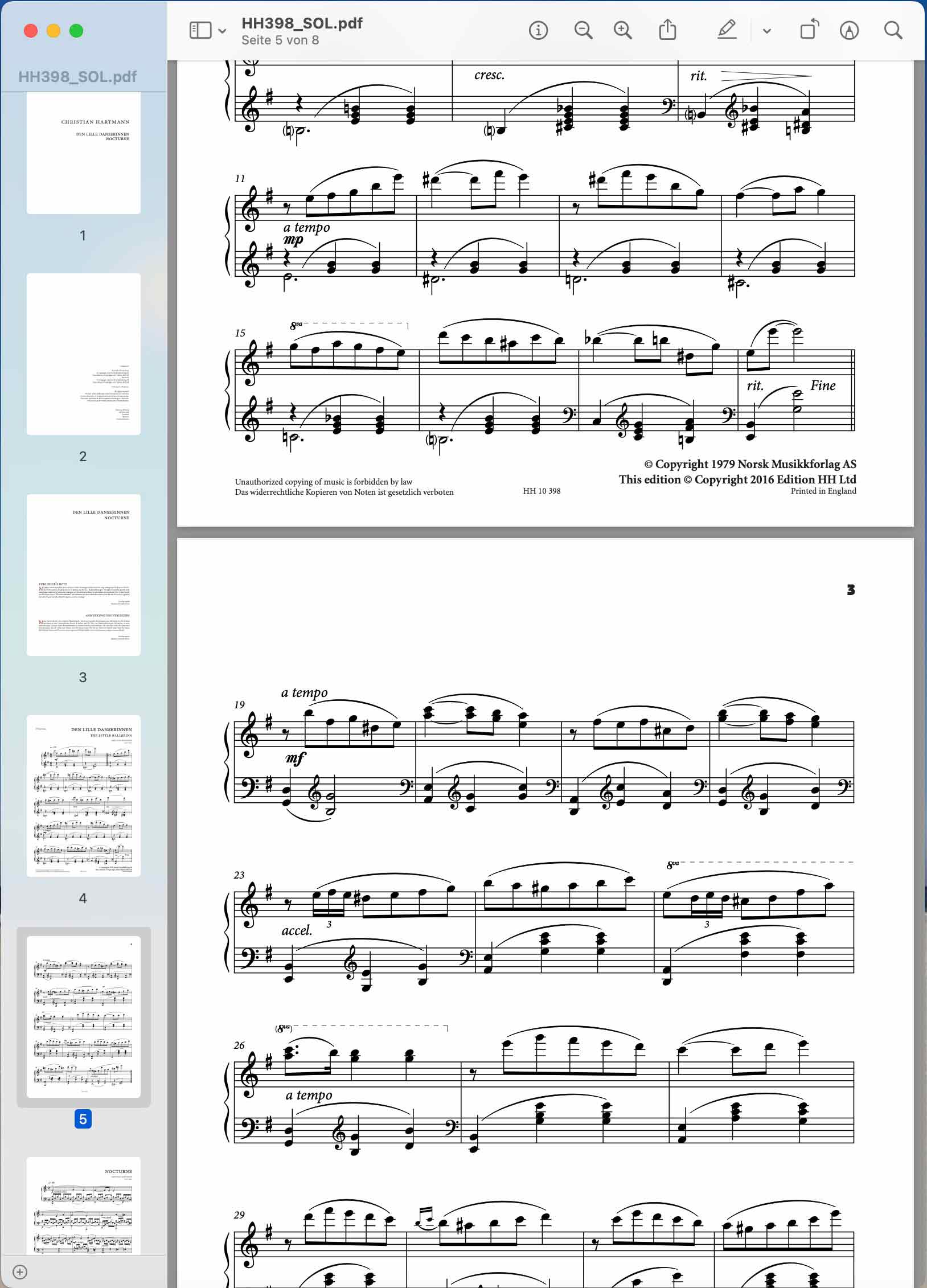

- That's an example for the content PDF
- Content_A4_Portrait.jpg (228.38 KiB) Viewed 10677 times
