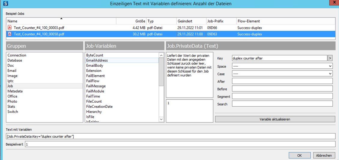

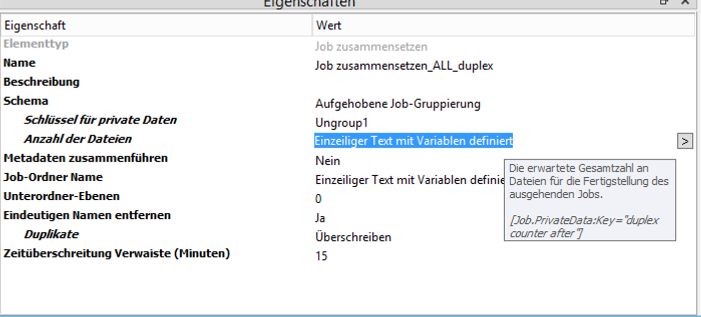

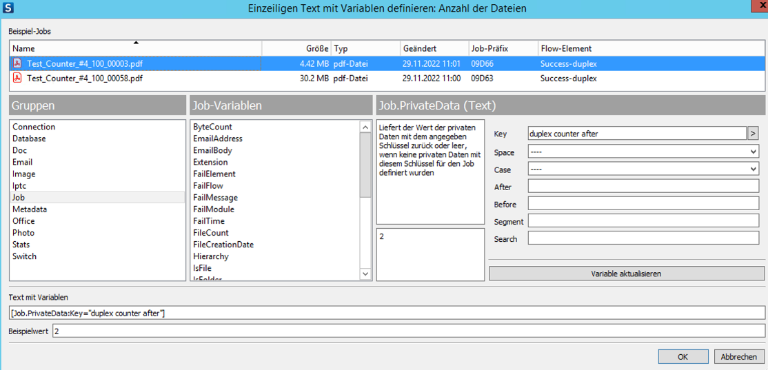

I've set it up as you explained, but it doesn't work. When two files run through the counter, then for the first file the private data after is 1 and for the second it is 2. So the assemble job element put the first file in one job Folder and with the second one nothing is going to happen because in that case no second file will come...
I attached some screenshots, maybe there is something wrong with my settings.
