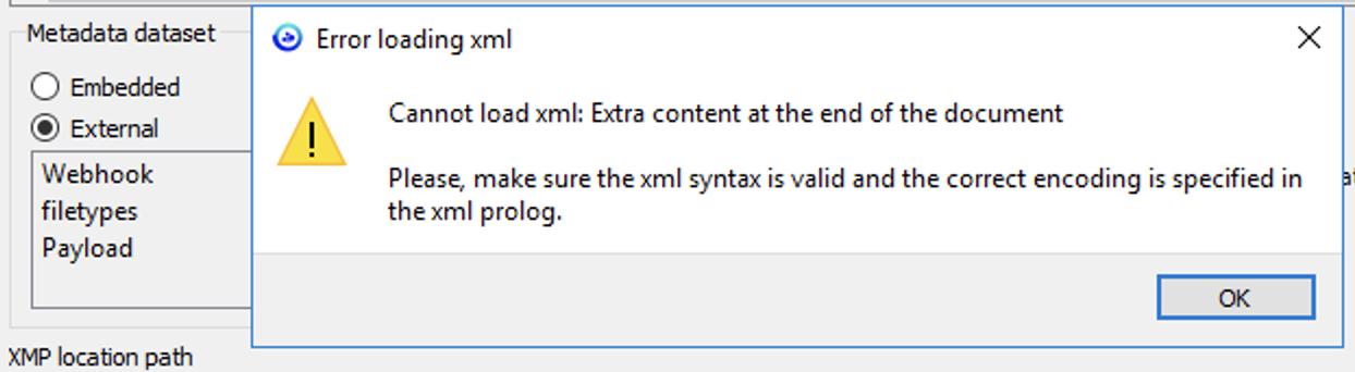

Thanks for the detailed explanation Freddy! Unfortunatly I cannot load the dataset, I get this error. I have tried with many different Switch jobs/files. If I choose JSON I can load the dataset. Any ideas?

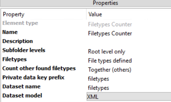

What version of Folder apps are you using? And what are the exact values of the properties?

freddyp wrote: Wed Nov 23, 2022 10:43 pm What version of Folder apps are you using? And what are the exact values of the properties?
Folderapps 4.0

I again, when I changed fileformat from .pm5 to .ps the XML works!
