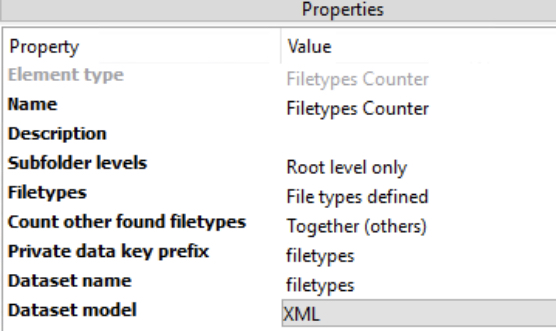

I got it to work. Here is the setup.
"Filetypes counter" with "Root level only" and "File types" defined as as a file type you never receive. The reason for choosing a file type you never receive is because "Filetypes counter" will list all the other file types in the XML under the node "/filetypes/others".
In the Metadata you choose TextIndexed, in "Build location path" you choose "XPath expression" and the XPath is /filetypes/others/item/name. You can then combine them using "Prefix - Suffix" (<li> and </li> if you want to have the files as list items in a mail template).

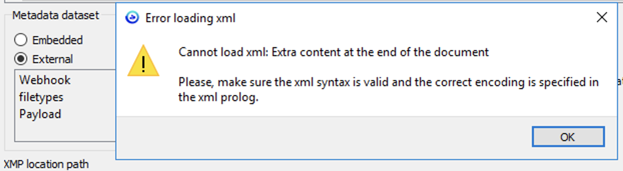

Thanks for the detailed explanation Freddy! Unfortunatly I cannot load the dataset, I get this error. I have tried with many different Switch jobs/files. If I choose JSON I can load the dataset. Any ideas?

What version of Folder apps are you using? And what are the exact values of the properties?
Re: Send mail (HTML) containing list of files from a Switch job
Posted: Thu Nov 24, 2022 1:48 pm
by magnussandstrom
freddyp wrote: Wed Nov 23, 2022 10:43 pm What version of Folder apps are you using? And what are the exact values of the properties?
Folderapps 4.0
Posted: Fri Nov 25, 2022 11:05 am
by magnussandstrom
I again, when I changed fileformat from .pm5 to .ps the XML works!
