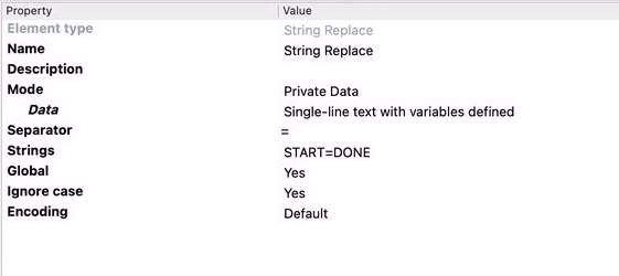

My process and how String Replace is setup:
I'm looking to change the value in privatedata key "description". ( in my test the value is START this test )
Mode: Privat Data
Data: [Job.PrivateData:Key="description"
Separator: =
Strings: START=DONE
Global: Yes
Ignore case: Yes
Screenshot 2023-01-02 at 11.27.00 AM.png (52.49 KiB) Viewed 17575 times
The result is the same "START this test" vs what it should be "DONE this test" as the new privatedata.
Am I missing something or is there another way?

In the Property "Data" you should have the name of the Private Data key.
In other words it should just say "description"
Then if there is a value "START" in that Private data value you will get the result "DONE", otherwise nothing will happen.

jan_suhr wrote: Mon Jan 02, 2023 7:39 pm In the Property "Data" you should have the name of the Private Data key.
I feel dumb now, but thank you very much. Of all the things I tried, this didn't cross my mind but makes total sense now that you pointed it out.
Works perfectly!!
Thanks again.
