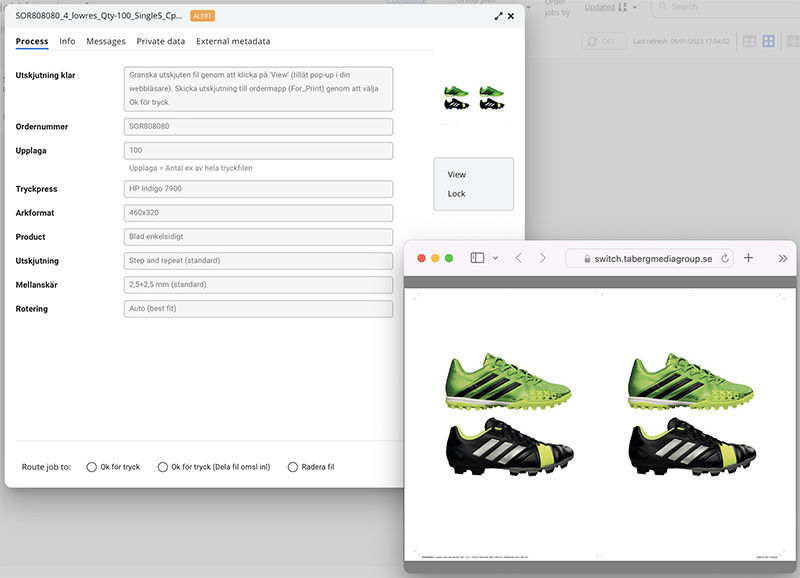

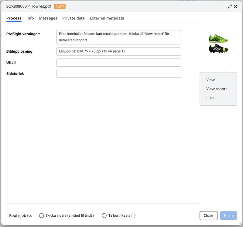

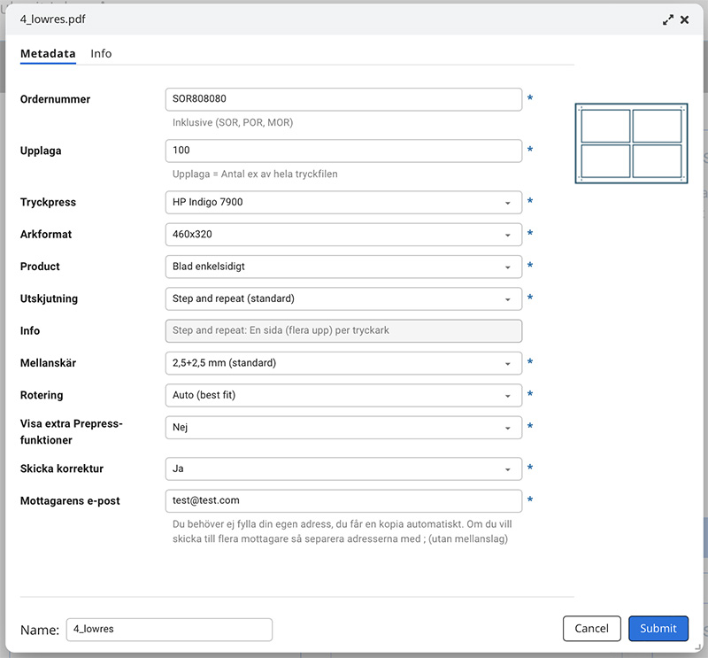

This is how it looks for our CSR's:
1. Submit job
2. Review preflight (only if any warnings or errors, in native simple language):
3. Review imposition
4. And a mail with link to PDF Review is sent to the customer and CSR automatically (if preflight is without any errors or if the CSR's continues the job).
I been backed by the management buliding this and I think it's really important to make the UI really simple and understandable, also provide something that the CSR's are missing today (Maybe imidiate repsonse, a sense of control or other things that makes the CSR appreciate their new tool instead of the feeling of "Are we also supposed to do prepress work now...!?"
