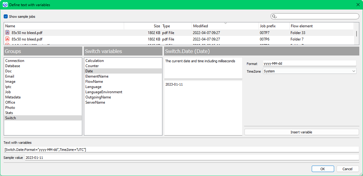

You can format the system date to look like 2023-01-10
And then you can use that to compare the date in the filename
