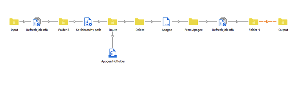

Maybe this work for you.
apogee flow.png (11.3 KiB) Viewed 17787 times
Apogee test.rar
(24.43 KiB) Downloaded 956 times

No, because when the file goes to 'board test' the job disappears from the Job Board.

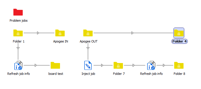

Thanks Jimmy, thats exactly what I was looking for. I did a quick test and it does the trick (almost)!
Since I have multiple Apogee hotfolders I'm using Set- and Archive Hierarchy, and Generic Application doesn't seem to understand that the file is back:
Skärmavbild 2023-01-26 kl. 09.36.56.png (34.34 KiB) Viewed 17734 times

Is the unique identifier in the filename the same?

JimmyHartington wrote: Thu Jan 26, 2023 11:33 am Is the unique identifier in the filename the same?
Thinks this is a support case for Enfocus, if that is the case.
No it's not the same since the the output are splitted. Can you think of any workaround?
I just sent a feature request for the Generic Application app to Enfocus:
I suggest that you add a property in the app that’s called ‘Identicator’. The default value could be ‘Switch unique prefix’, but it can be changed to ‘Inline text’ or ‘Define single text with variables’.

I do not have an idea for a workaround at the moment, if the unique indicator is stripped.

magnussandstrom wrote: Thu Jan 26, 2023 12:47 pmCan you think of any workaround?
Does the output from Apogee have something which can identify the original file?
If so, a workaround could be to route the original file to a temporary folder, so it is still visible in the job board.
When the output comes it triggers an action which deletes the original file in the temporary folder. Then it disappears from the job board.
Of course some of the files can not delete it since the output it split, but they should just fail silently then.

The unique identifier isn’t stripped the issue is that the unique identifiers differs between the files that sent to Apogee with Archive hierachy and the file placed in the Generic application folder.
I will try the temp file solution. I need to put it in a folder thats not the last folder in a flow.. Then I won’t be using the generic application app. I’ll try it tomorrow.
