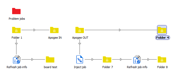

Maybe this work for you.
apogee flow.png (11.3 KiB) Viewed 17799 times
Apogee test.rar
(24.43 KiB) Downloaded 956 times

joaodaffonsojr wrote: Tue Jan 24, 2023 5:22 pm Maybe this work for you.
No, because when the file goes to 'board test' the job disappears from the Job Board.

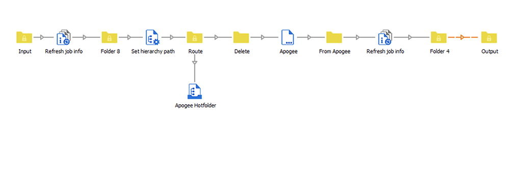

There is the "Generic Application" flow element.
Maybe that can be used. Have not had a scenario like this, but it could look like this:

Thanks Jimmy, thats exactly what I was looking for. I did a quick test and it does the trick (almost)!
Since I have multiple Apogee hotfolders I'm using Set- and Archive Hierarchy, and Generic Application doesn't seem to understand that the file is back:
Skärmavbild 2023-01-26 kl. 09.36.56.png (34.34 KiB) Viewed 17746 times
