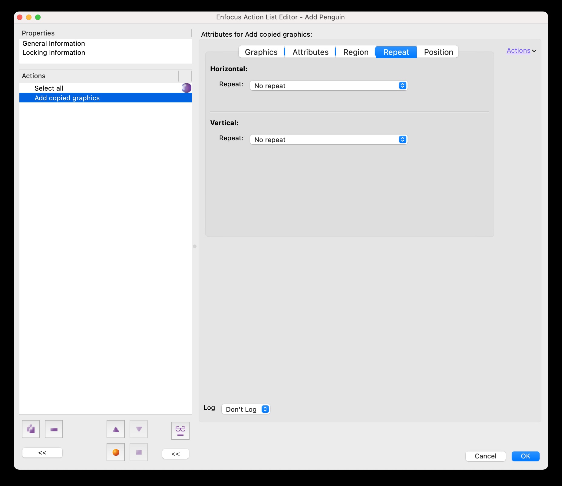

Too many variables to make a generic action as the action already works. It's just not to step & repeat as set. Edit the action, or double click it to edit and go to the Repeat tab and configure it according to your needs. You would need to post a PDF with what you want repeated and the values that they need to repeat.
Screen Shot 2023-02-02 at 11.32.08 AM.jpg (185.01 KiB) Viewed 12334 times
