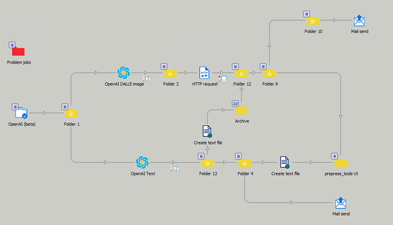

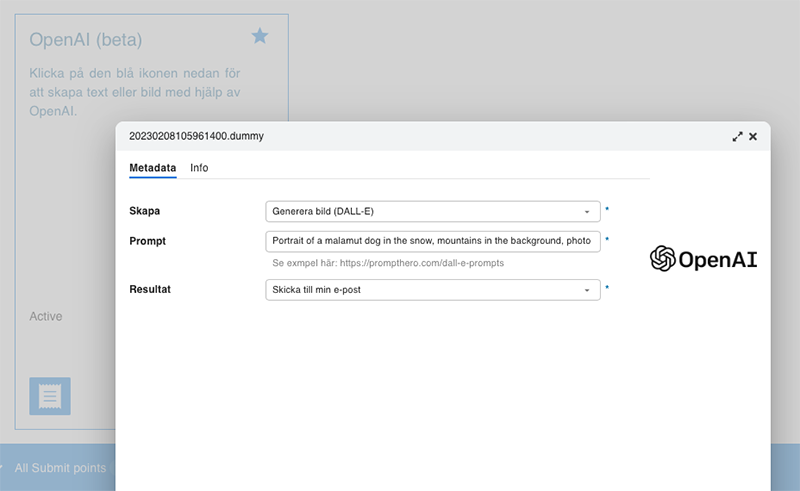

Wow! I just love the new free OpenAI-app. Yesterday I built a simple flow, starting with a submit point, for our 50 Switch-users to enjoy. A great and playful way to get to know AI and what it is possible to do. Everybody in the office is talking about it by now. :D

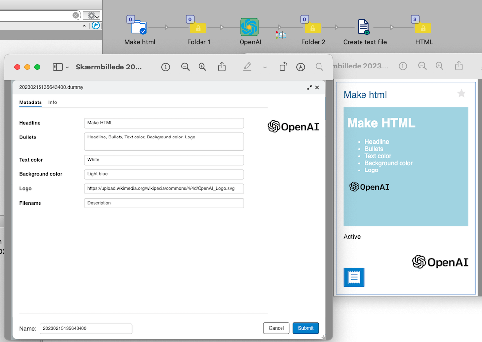

It really is a very usefull app :) I know nothing (almost) about HTML but I like the idea of being able to make Submit Points look better in Switch using HTML for the Display description. So I made this simple flow and used the variables from the Submit Point to ask Open AI to generate the HTML code. In seconds it generated the code that I could just copy and paste into the Display description :o
Skærmbillede 2023-02-15 kl. 14.00.26.png (167.97 KiB) Viewed 328361 times

@terkelsen: What is the settings for the OpenAI configurator to do this?

@JimmyHartington. You just write a plain text telling Open AI what you want. In my example I have written the request in my own language, but fortunately we share that :) It makes no difference in what language you write your prompt and you can even use Hex Codes for the colors if you like. My prompt just looks like this.
Lave en html med en punktliste. Overskrift [Metadata.Text:Dataset="Submit",Model="XML",Path="/field-list/field[1]/value"] . Punkter [Metadata.Text:Dataset="Submit",Model="XML",Path="/field-list/field[2]/value"]. Gør teksten [Metadata.Text:Dataset="Submit",Model="XML",Path="/field-list/field[3]/value"] og baggrunden [Metadata.Text:Dataset="Submit",Model="XML",Path="/field-list/field[4]/value"]. Indsæt nederst men indenfor baggrunden dette logo med en bredde på 90 pixel [Metadata.Text:Dataset="Submit",Model="XML",Path="/field-list/field[5]/value"]. Holde en afstand på 5 pixel hele vejen rundt.

En meget opfindsom tilgang. Godt klaret!

Very creative :D

Great idea! :idea:
