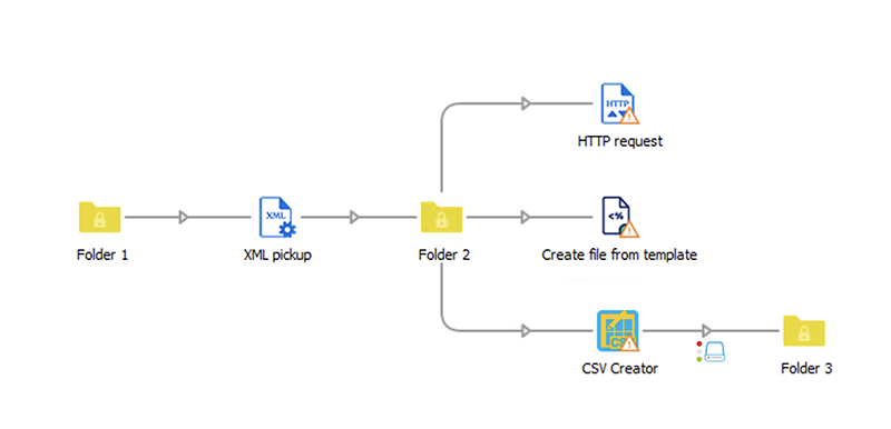

You need the Metadata Module in Switch to do this.
This is a flow thats starts with an XML pickup and three different outputs of choice:
XML pickup (metadata is asset) = This app "picks up" the XML and makes the different XML-values available for Switch (as metadata) so you can use that data downstream.
HTTP request = API communication
Create file from template = A free app where you can create CSV-files
CSV Creator = A paid app to create CSV-files
XML pickup (metadata is asset) "picks up" the XML and make the different values available for Switch (as metadata) so you can use that data for the output.
I hope this points you in the right direction
