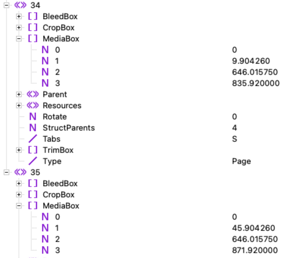

The last page of the document has an origin that is different from that of the other pages and that is indeed the reason why [Stats.PageBoxesEqual] returns False. Well, nothing new, you had already figured that one out.
I logged it as a bug, but I am anticipating a bit of a debate. If you look at the internals of the PDF file you see that there is a difference between the last but one and the last page, so the boxes are not equal. However, the sizes are equal when you do the math, so the page boxes are equal. Which one is it? I am on your side :D. The output intent has nothing to do with this. The only explanation I can see is that the origin was reset by Acrobat when saving the file after you removed the output intent.
