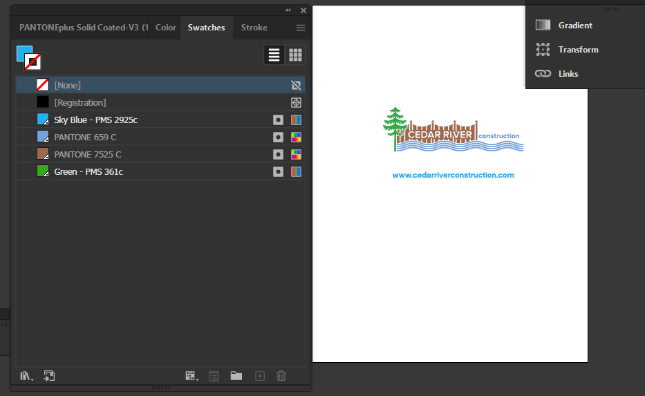

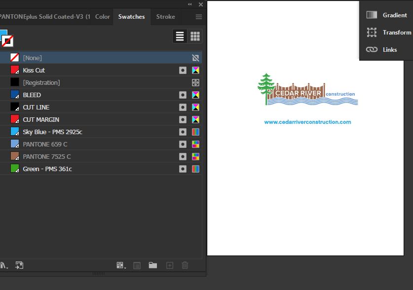

There are swatches listed in swatch panel not in art file I am wanting to remove. I could only attached images
- Unused swatches removed from swatch panel removed

- Swatches not in art file

Ok, but those are swatches inside Illustrator and unused swatches can be removed just as you did. There could be zillions of reasons why those extra colors get there in the first place but if those colors aren't used in the layout, there shouldn't be found in the PDF, so no need for an action list.

Ok, I think I got you now. You are probably working with Illustrator Files saved as Compatible PDFs. So basically, you can see those extra colors when opened with Illustrator but there are not visible in the PDF when inspected in Acrobat. That's because Compatible PDFs embark both PDF data and Illustrator Binary Data. PDF Data is what is displayed with Acrobat or what you can see when importing the PDF inside InDesign for example. The Binary data is the actual Illustrator file saved inside the PDF.
If you really want to remove those unused colors, you will only be able to proceed inside Illustrator either manually or with a script.
See here for an example: https://community.adobe.com/t5/illustra ... 99#M189711
This could be used in a Switch Flow if you want to automate and scale this process.
If you are using a tool that process your PDF file and see those unused colors (outside of Illustrator), please precise which one. Otherwise, the PDF data (not the Illustrator Binary data) should only contain colors that are actually used inside the layout.
