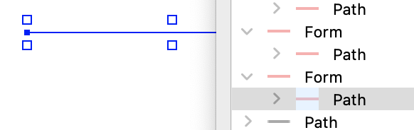

The container box as you call it is a form. You can easily see that when you use the "Object browser" from the "PitStop" menu.
Screen Shot 2023-02-23 at 10.53.39.png (23.63 KiB) Viewed 15079 times
These forms have nothing to do with interactive forms where you can fill in information. They are just PDF constructs for grouping objects in a certain way and although indispensable in many cases they also often do not really contribute to the structure of the PDF, as is the case here. On the other hand, if they do not really contribute they also do not hurt, so why do you want to get rid of them?
You could now say, but I have "Select forms", "Remove selection" in my Action List. This only removes empty forms. If you removed non-empty forms you would be in for a very big surprise because forms are all over the place (plus forms within forms within forms).
