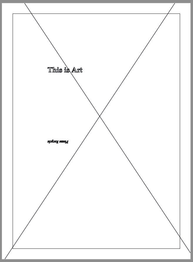

The object in question appears to be the bounding box of the PDF we placed in InDesign.
It has four nodes, and no properties other than size and position.
A wireframe screenshot is at the end of this post
We will take client submitted PDFs, preflight them with Pitstop, run them through Esko Automation integrated with Pitstop actions, to output to digital, or litho, and in this case, a flexo plating system. In simple terms, with flexo we crop to visible, add a half-inch around the graphics, and apply a distortion relative to the machine the job will run on. It appears to be treating this box as visible, as you can see the distorted half-inch border.

- Screen Shot of Wireframe View.png (29 KiB) Viewed 16961 times

The Inspector shows at the top what type of objects are currently selected. When you select that cross you will see it says "1 Form Selected". You can also do that by using the PitStop Object Browser (it is in the PitStop Pro menu). The extra you get there is that you see what is inside the form, in this case the paths that make up the words "This is Art" and "Please recycle".
This is not the cause of your problem!
Using the Object Browser you will see that there is a white background (it is the first object at the top, meaning it is the bottommost object). That is the cause of your problem. OK, it is white but it is an object with a fill.
If you want to place the crop box around "This is Art" and "Please recycle" you have two options. You can remove the white background (Select color, Remove selection) and then do "Select visible objects, Change crop box) or you select the objects using "Select color range, Change crop box).

That was it. To see the hidden problem, I used Select Object while in Wireframe mode, and it didn't give me any values. Object Browser is new to me, and I can see how that tool will become very useful in the future. Thank you.
