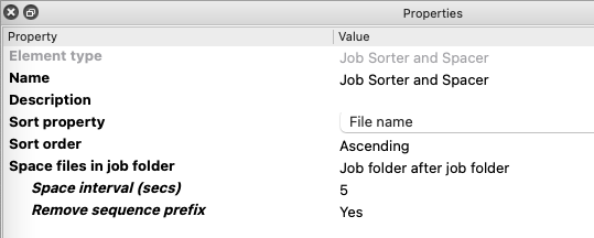

1. You can use the hold element, and on the outgoing connection, use the space jobs apart property.
2. You can use the Job sorter and spacer app, part of the Folder apps bundle.
Job sorter and spacer.png (30.92 KiB) Viewed 5096 times
Both methods work fine, but you have to estimate the time it takes to process a job.
And sometimes Switch will wait too long if a job is processed faster.

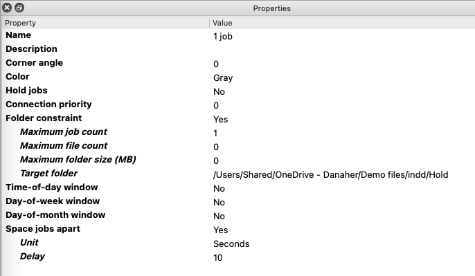

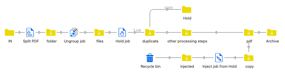

So here is solution 3, a bit like Jan's answer:
Send a copy of the job to a hold folder.
Use a hold element with space jobs apart property and folder constraint upfront, as illustrated.
At the end of the flow, inject that job from the hold folder, so that the next job can start.
This acts as a gatekeeper.
If you want the files to be processed in a certain order (e.g. alphabetically), replace Ungroup Job with the Job sorter and spacer app.
one job at a time.png (29.09 KiB) Viewed 5093 times
Hold outgoing properties.png (51.45 KiB) Viewed 5096 times
