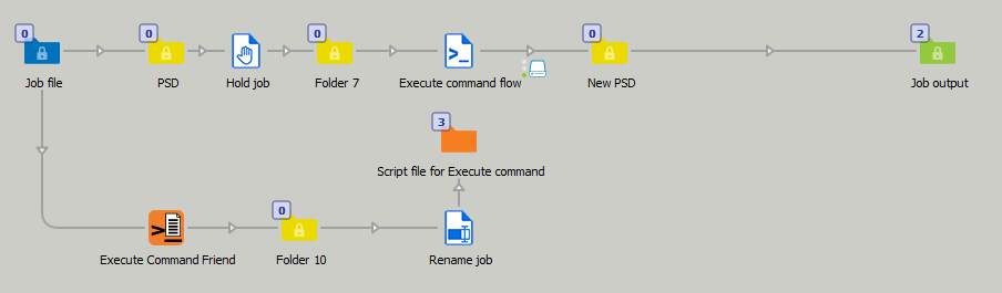

Flow looks like this since we have to save the BAT-file for execute command to pick it up. It will be over written with the next job.

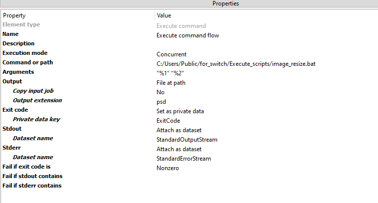

Here is the settings.
The %1 variable that Execute command uses is the full path to the incoming file. So you just set it up as in the attached screen shot and it will work for you.

Thanks! It works now, but i was afraid there would be an issue if multiple users uses this flow at the same time since we are overwriting the same .bat file and when testing this by putting two images in the flow with different sizes they both came out with the same size. So there is an issue with this.
I will try to go back to my first set up where every job gets it's own bat file.
