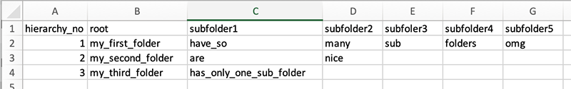

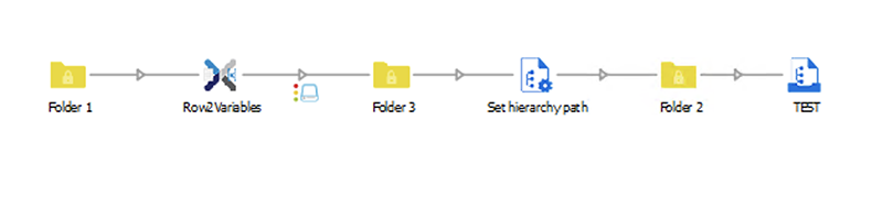

Hi, not scriptning, but maybe you can use the App Row2Variables, like this:
