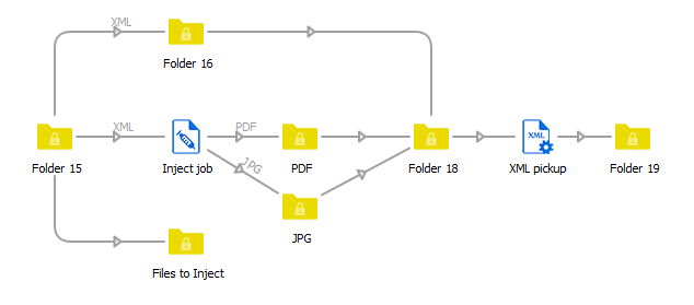

This could work for you.
You send the PDF and JPG files to a disc folder. The XML go to Inject job and one XML pass the Inject job so we can use it later.
Then the PDF or JPG get injected and meet the XML in folder 18 for the XML Pickup.

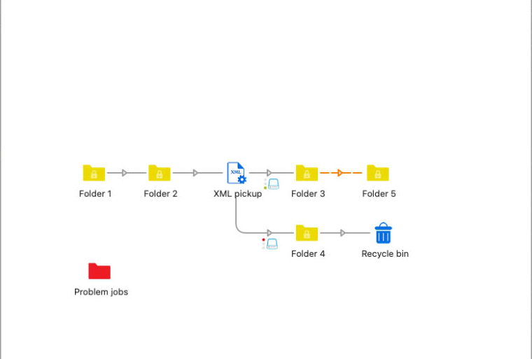

I was testing on a server running Switch2022 Fall, and recently updated all the apps, and it would appear they've added a traffic light connection to the XML Pickup app. What's odd is that it's not listed int he change log for the app update, nor in the documentation in the App Store. Anyway, something like that would probably be the easiest way to do what you're after.
Screen Shot 2023-11-21 at 13.12.45.png (51.42 KiB) Viewed 20150 times

@jslater, I wasn't aware of that change in the updated version of XML Pickup. That obviously solves the problem in the best possible way. Thanks for making me aware of that.
