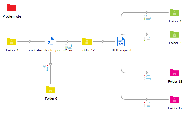

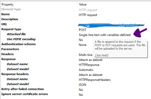

  • Create a JSON file as the API need
  • Config the HTTP request to use this JSON on FilePath
