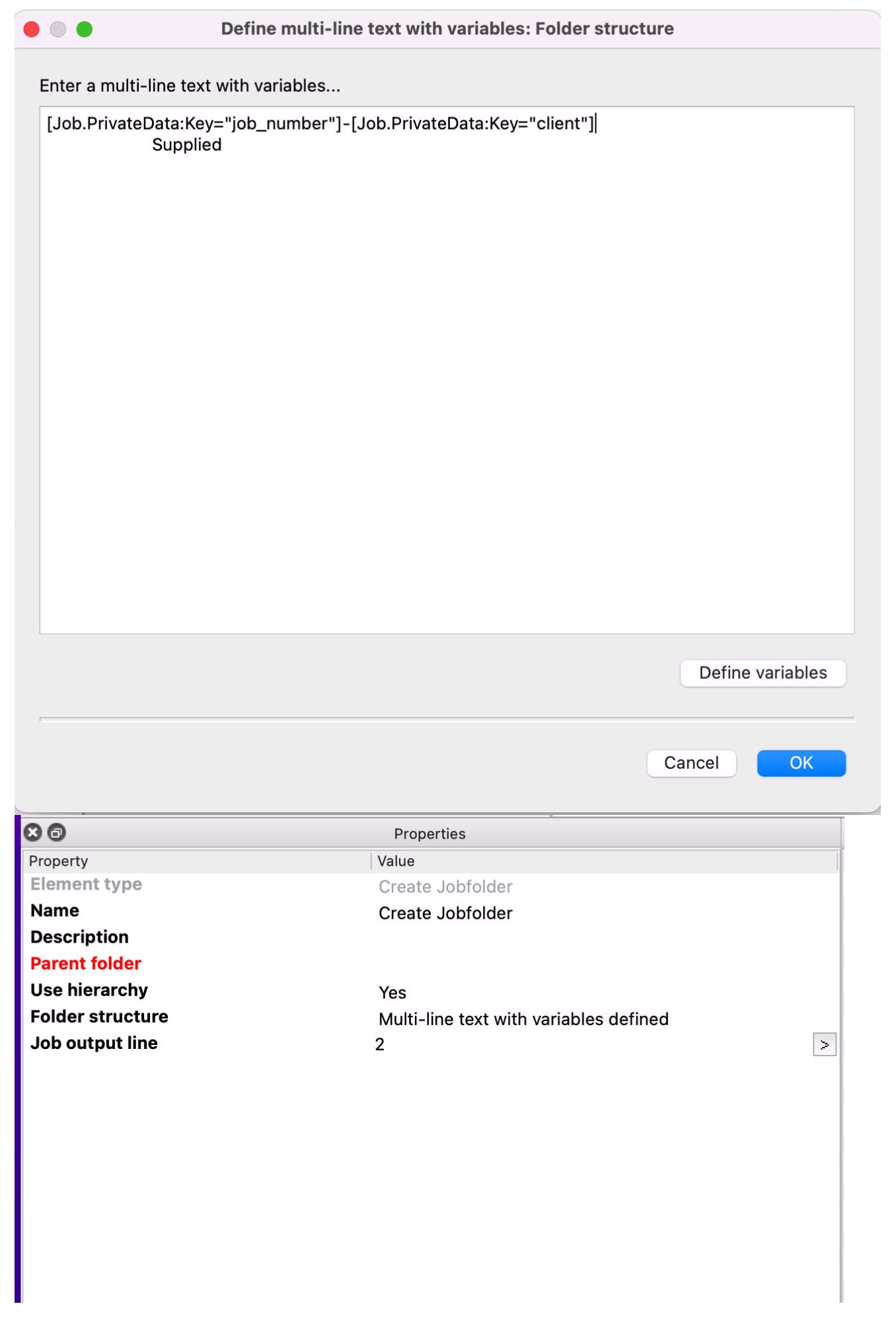

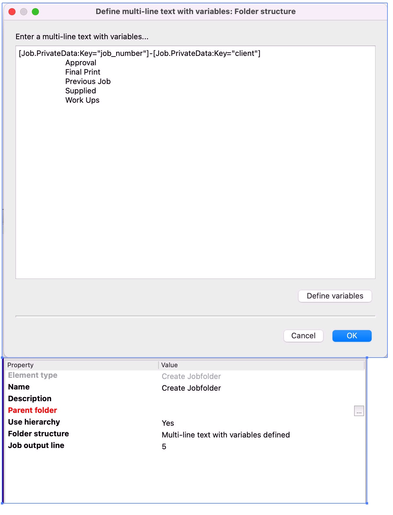

We do ours similar to what mag posted.
We do not put the job number on the file but rather type or select it when submitting in most cases, then use the job number as private data to drive the job and folder structure and creation. We do have some flows were the number is part of the file name, and we us a segment for the job number or before '-' like mag does.
From there we can use app Create Job Folder and have the top level be the variable of the job number and client name, and then list the hierarchy. Each tab is another level in.
We set the job output line to the folder you want it to go it, in this case 5.
Screenshot 2024-01-19 at 12.38.05 PM copy.jpg (217.08 KiB) Viewed 4819 times
Since the folders already exist, you can just use the top level (job+client)and only the second level folder the file needs to go in, Supplied.
2 folder version:
Screenshot 2024-01-19 at 12.37.47 PM copy.jpg (177.13 KiB) Viewed 4819 times
