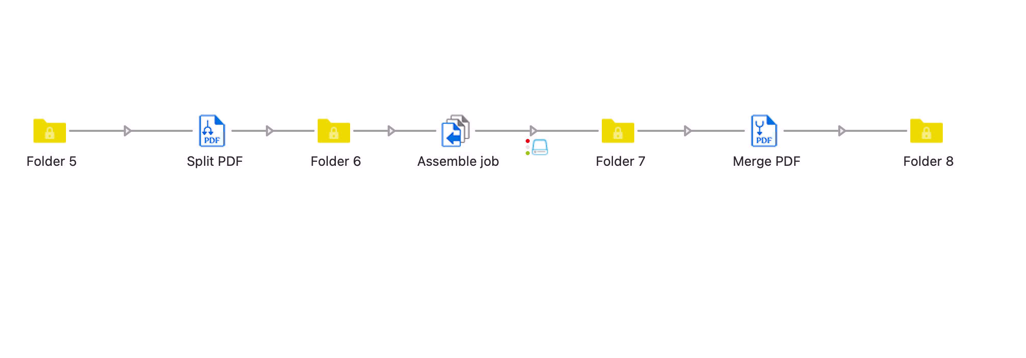

After you split them them must be assembled into a folder, using assemble. From there you can use the Merge app to combine them into one.
Screenshot 2024-01-19 at 1.13.30 PM.png (98.37 KiB) Viewed 4560 times

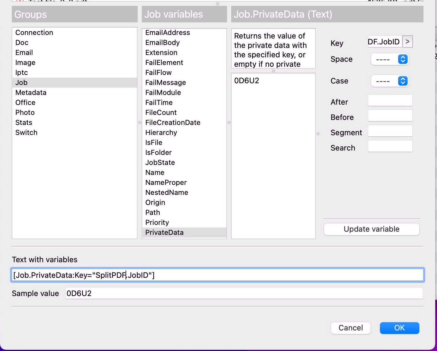

I'm using the split PDF pages tool, not the .split pdf one. Hope that makes sense.
Screenshot 2024-01-19 at 19.22.50 2.png (18.79 KiB) Viewed 4526 times

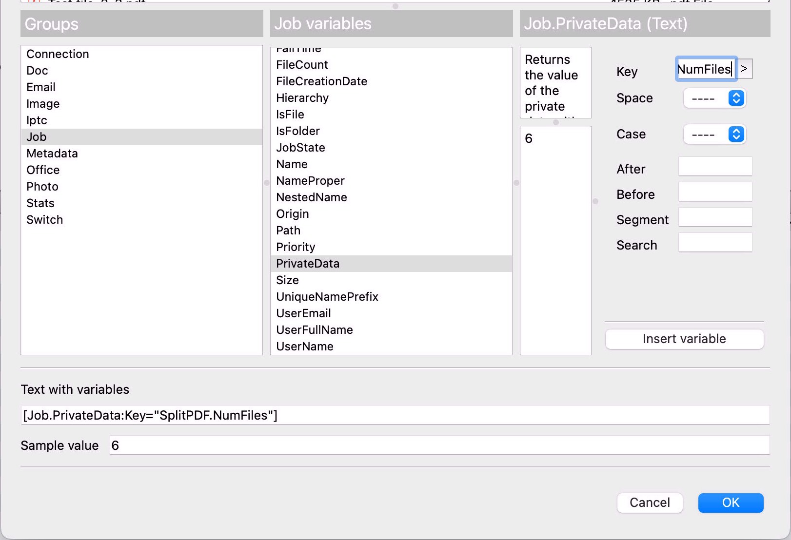

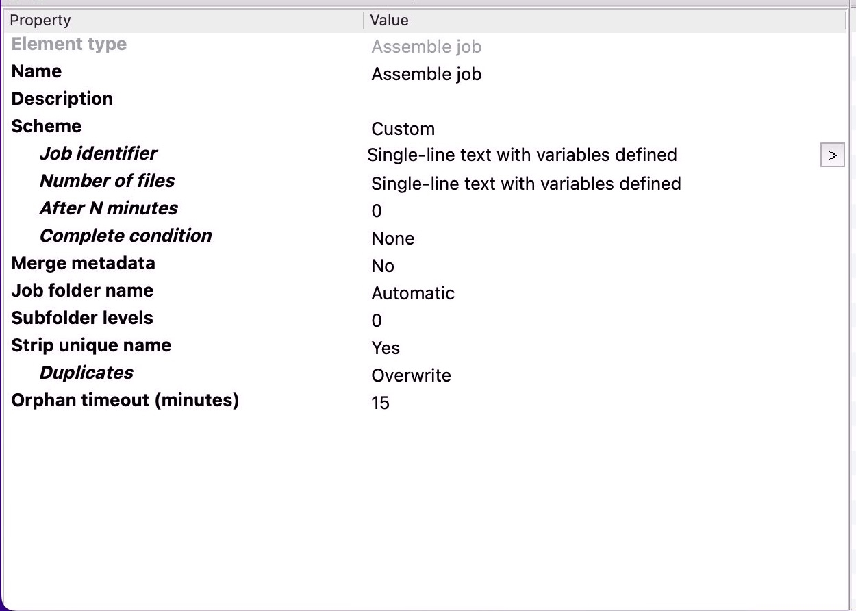

Depending on how you want to merge the files, you can use the privatedata it creates to help the assemble. We use the <key>.NumFiles a lot for the assemble along with the <key>.JobID
Custom Scheme:

Job Identifier
Screenshot 2024-01-22 at 5.22.34 AM copy.jpg (246.91 KiB) Viewed 4390 times
Number of Files
Screenshot 2024-01-22 at 5.22.02 AM copy.jpg (190.19 KiB) Viewed 4390 times
The result will be all the files into a folder, and that folder passed to the Merge app will assemble them into one PDF.
Hope that helps, HAPPY SWITCHING!

Thanks for getting back to me, I did find a work around by entering in the Private Data key box "SplitPDF".
Thanks for the screenshots and other info will come very in handy for the future.
