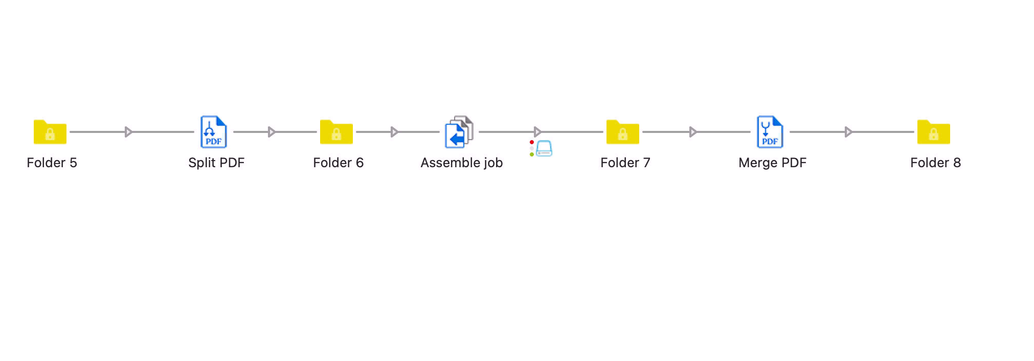

After you split them them must be assembled into a folder, using assemble. From there you can use the Merge app to combine them into one.
Screenshot 2024-01-19 at 1.13.30 PM.png (98.37 KiB) Viewed 4566 times

It would be the same. You need to use an assemble the split pages into a folder, once they are in a folder the merge will put them back to a single PDF.

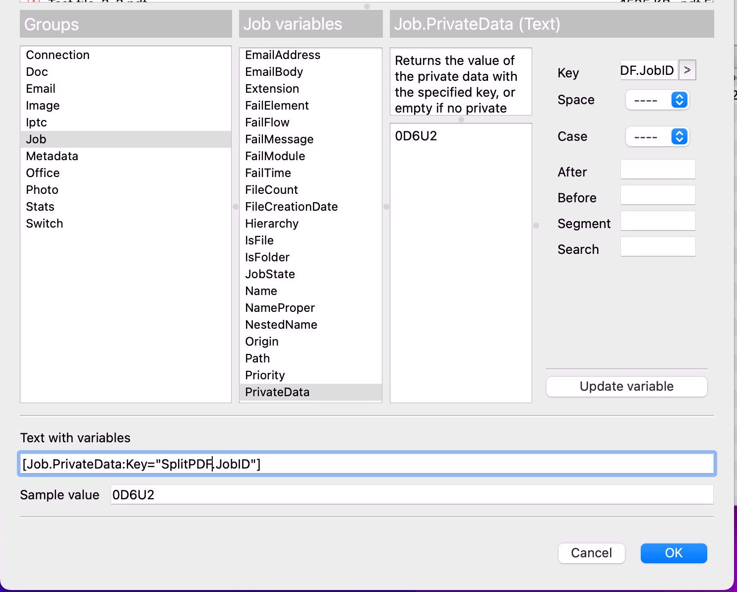

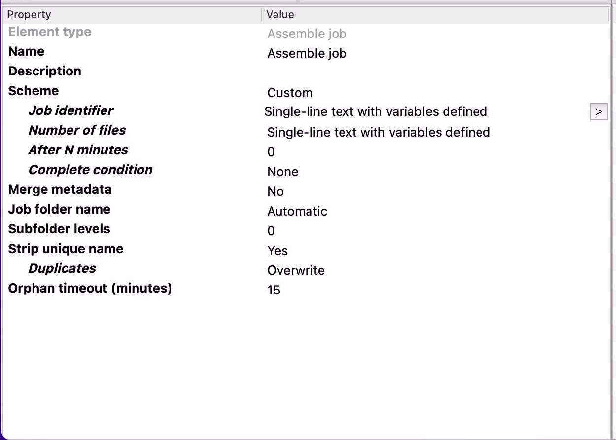

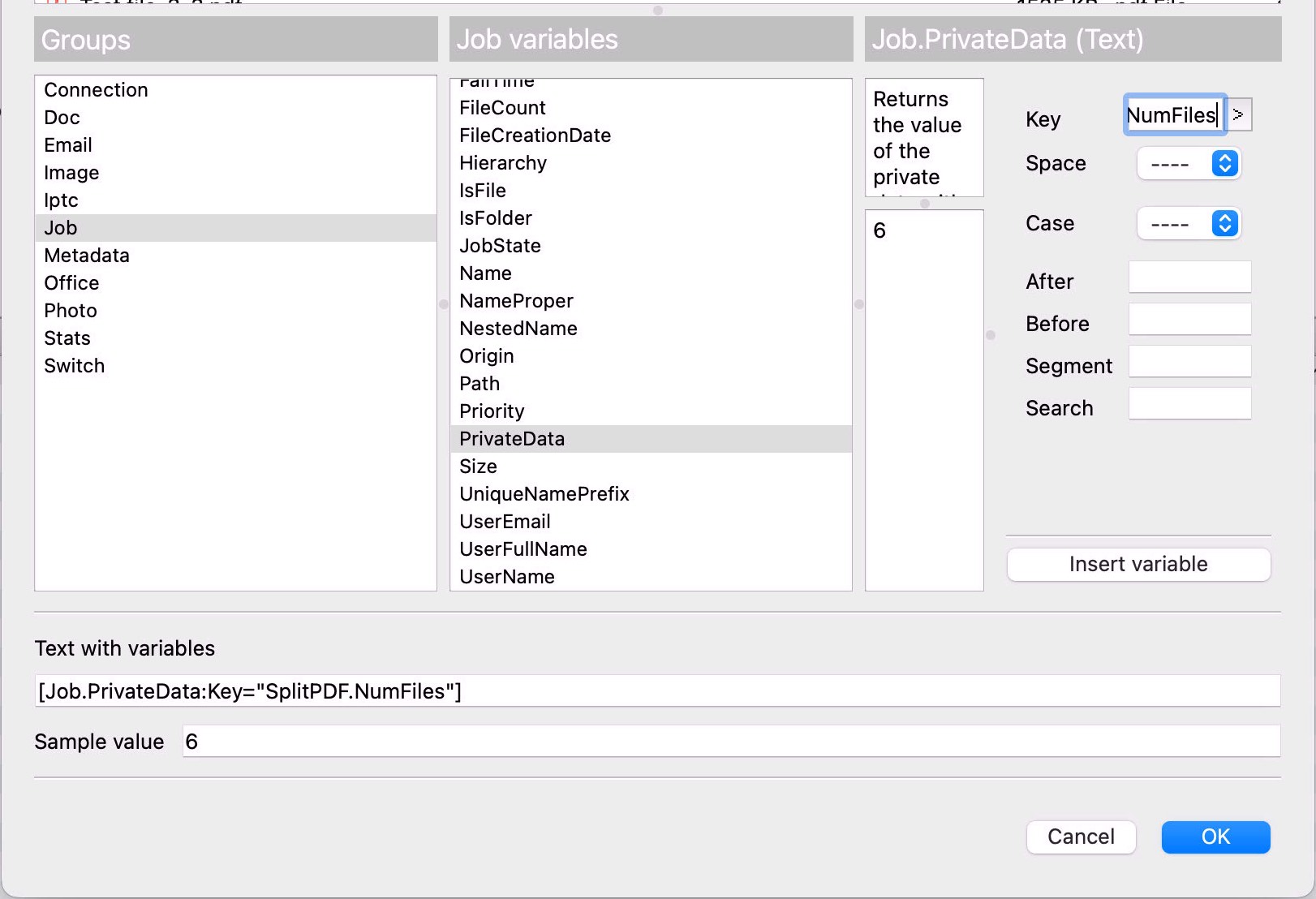

Depending on how you want to merge the files, you can use the privatedata it creates to help the assemble. We use the <key>.NumFiles a lot for the assemble along with the <key>.JobID
Custom Scheme:
Screenshot 2024-01-22 at 5.22.47 AM copy.jpg (131.65 KiB) Viewed 4396 times
Job Identifier
Screenshot 2024-01-22 at 5.22.34 AM copy.jpg (246.91 KiB) Viewed 4396 times
Number of Files
Screenshot 2024-01-22 at 5.22.02 AM copy.jpg (190.19 KiB) Viewed 4396 times
The result will be all the files into a folder, and that folder passed to the Merge app will assemble them into one PDF.
