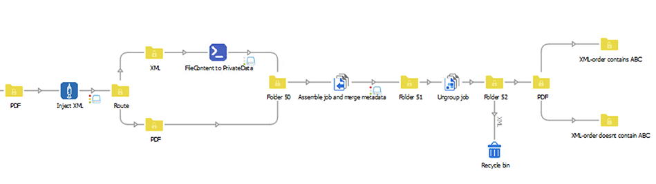

Hi, I need to sort PDF files dependent if there are other job-lines in the same order that contains a certain type-value (lets say ABC).
The number of job-lines can vary (Example XML below).
My take on solving this is to inject the XML as private data (see screenshot) and then use the condition: if [Job.PrivateData:Key="FileContent"] contains ABC. This way I can look for a specific value anywhere in the XML-order. But it's an awkward solution.
There is probably a much more simple way of doing this. Any suggestions?

I am not sure it is perse simpler, but it is certainly cleaner if you use an XPath expression. What you do in the left-hand side of a condition is choose Metadata - Integer; in building the location path you choose XPath expression not XML location path which is the default. The expression is (not tested on your data, but you will understand how to interpret it):
count(/order/jobs/job[type='ABC'])
If it is greater than 0 it means there is a job with type equal to ABC and that takes in one direction, all other jobs in another.

Freddy, this is exactly the type of answer I was hoping for. Thanks!
