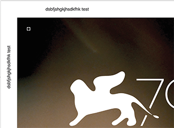

We are making banners for a customer. we print the banner with extra seem for the gromits en ta tekst file with the discription of the banner there (see picture). Now the customer wants to have a little thumbnail picture next to the text line. Is this possible to make in pistop?

Im trying to put it in my flow.. i m getting a thumbnail on a second page but im not getting it on the first pag next to the text lines in the seem.

I see that you paste the thumbnail at the end of the action list: Select page 1, Paste objects from clipboard. That is indeed not going to paste on page 1 in a multipage document.
It is important to realize that PitStop by default runs through the document from the beginning to the end without going back. Therefore
Select last page
Copy something
Select first page
Paste it
does not work. However, there is an action that allows to start all over again: "Split Action List". So:
Select last page
Copy something
Split Action List
Select first page
Paste it
will work.
It is a long action list so I have not studied it in detail, but the conclusion is: if the page from which you make the thumbnail is also page 1, move the paste higher up in the action list; if the thumbnail page comes after page 1, Split Action List.
